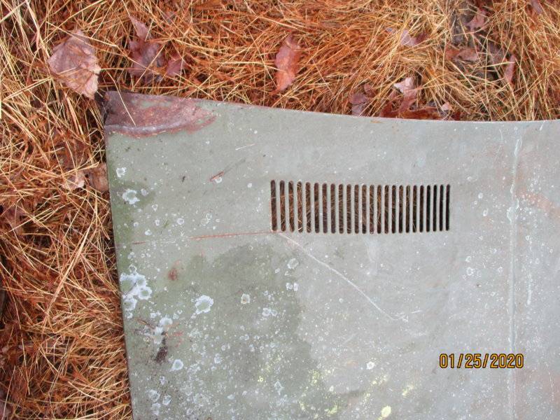

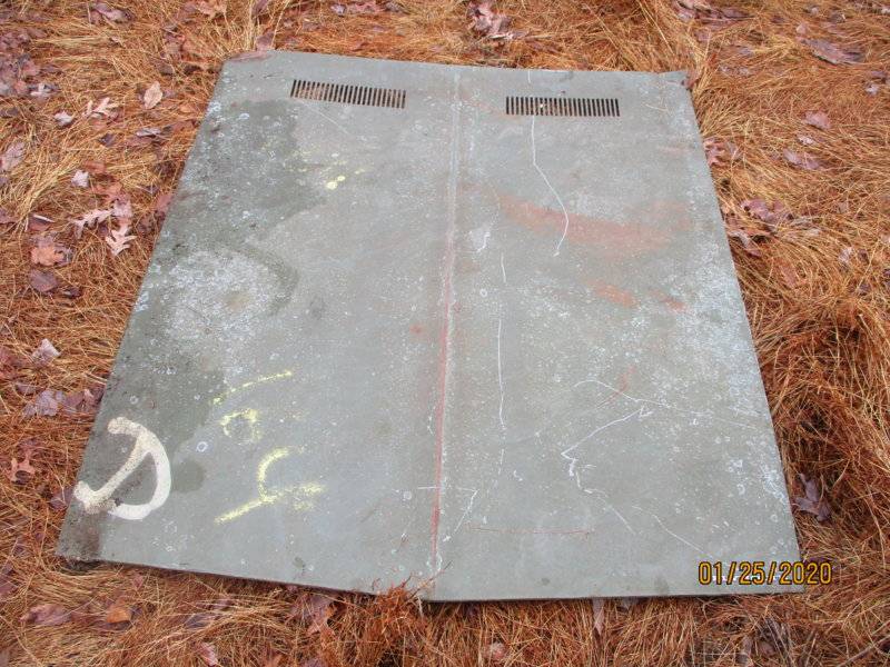

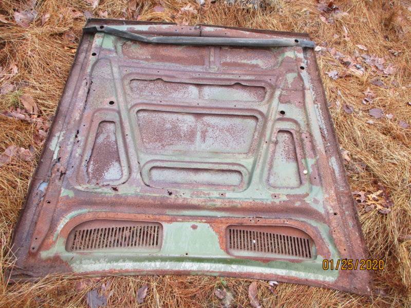

Anyone tell me what year and model this hood is?

What is this hood to?
thanks,

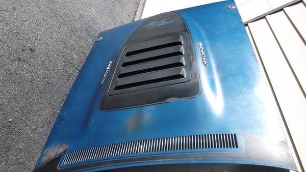

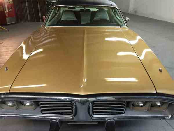

It will fit 71-74 Charger, but is correct for 1973. See attached pics for differences in the cowl vents between the model years.
Early 71 hood
Late 71 and 1972 hood
73 hood
74 hood
No, it cant be a GM piece or dodge because if you look down on the bottom right side of hood it says Plymouth on it.
I hadn't noticed that, also the front "peak" isn't as defined as the charger hood. it would have to be a 73+ satellite wagon or 4 door ??
I don't see where it says 'PLYMOUTH'.....I do see a lot of rust on the strengthening swages.
Ah ,now I get it. There is a photo date stamp over the plymouth nameplate that makes it impossible to read!
Better photos might have made the job easier. :lol:
