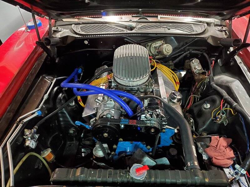

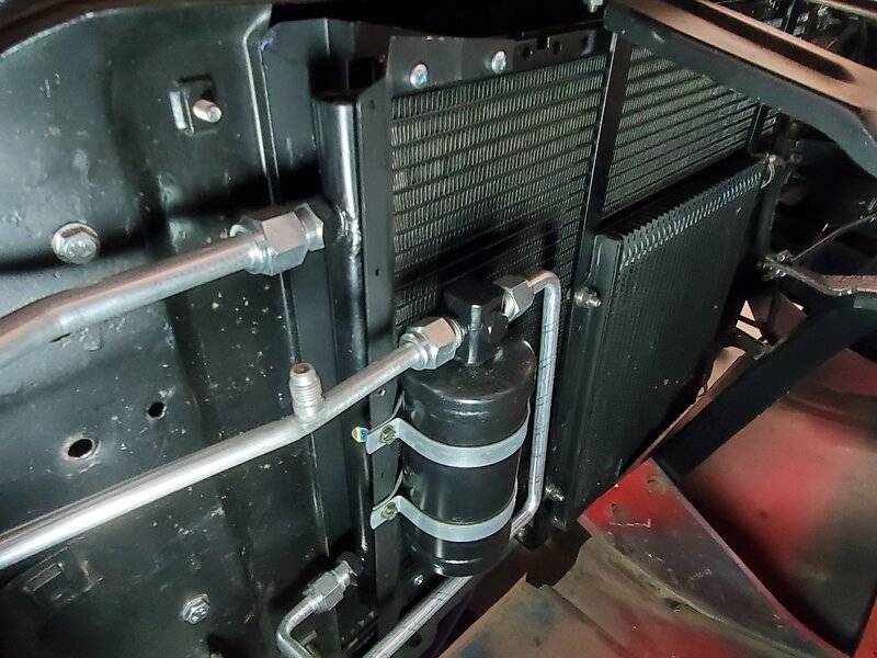

I used vintage air in my 1971 charger non ac car. It took some work but its in and works really good.

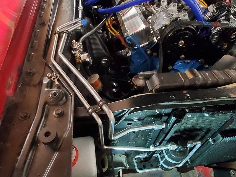

I've made my own lines as I didn't care for their routing.

Can some of the guys who have used the various systems post some pictures?

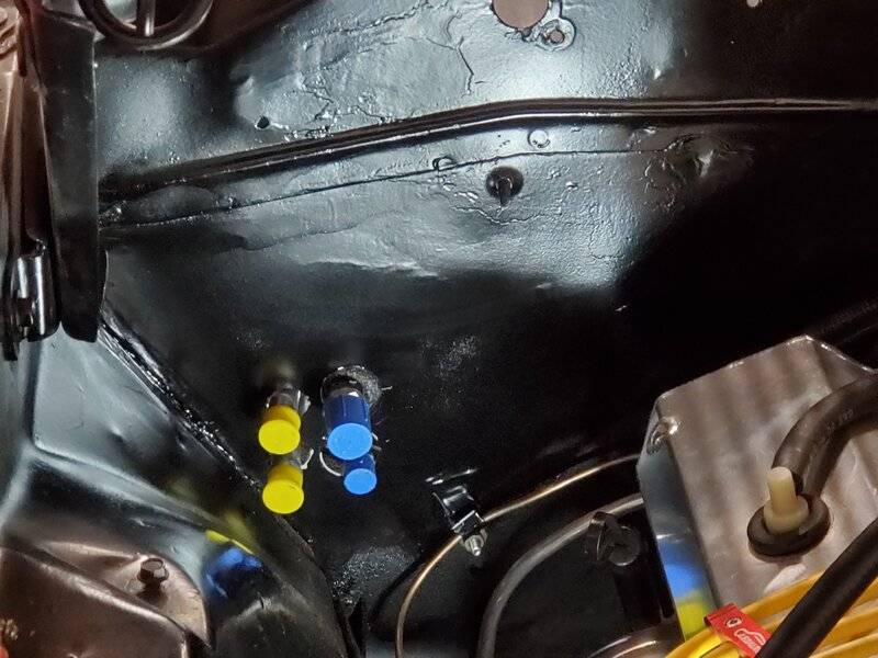

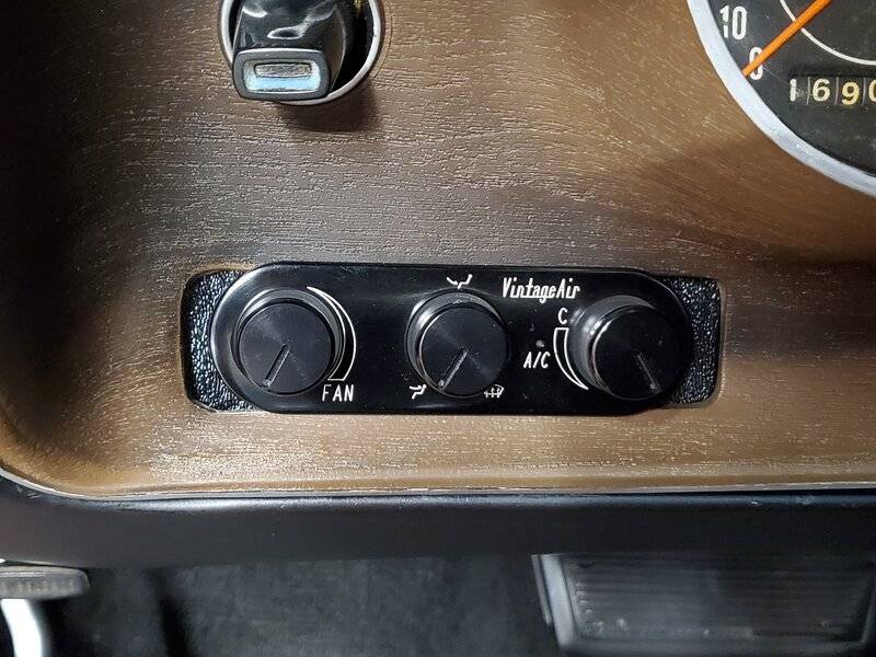

I did cut the firewall and welded in a piece to drill the holes where I wanted them. I tried to make it look like it should have been. The ac controls are no big deal. I bought a piece of abs plastic and used a heat gun to form it to fit the cluster. Drill it so the controls fit the plastic and the will fit without cutting the cluster.
