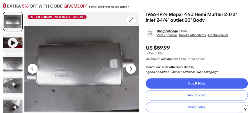

On a tight budget? Make offer. (not mine)
Those could be Accurate mufflers, not sure. If so that’s about 1/3 their list price.
Edit: No, I don’t think they are. I don’t see the corner bead crimps. Still might be a good buy.
