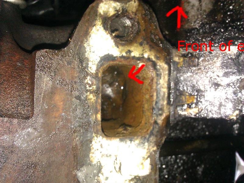

I just pulled the intake off of my 318 (gaskets were leaking coolant) and found that a hole about an two inches down inside of the front coolant passages (this is the driver's side) had hard pebbly debris hiding in it.
The wider section of the passage and the intake itself are clear. Is this a secondary passage that's plugged up, or just some casting cavity that's filled up with gunk but doesn't flow anywhere? What's the best way to get this stuff out without pulling the heads Both times I've drained the system recently no funny junk came out.

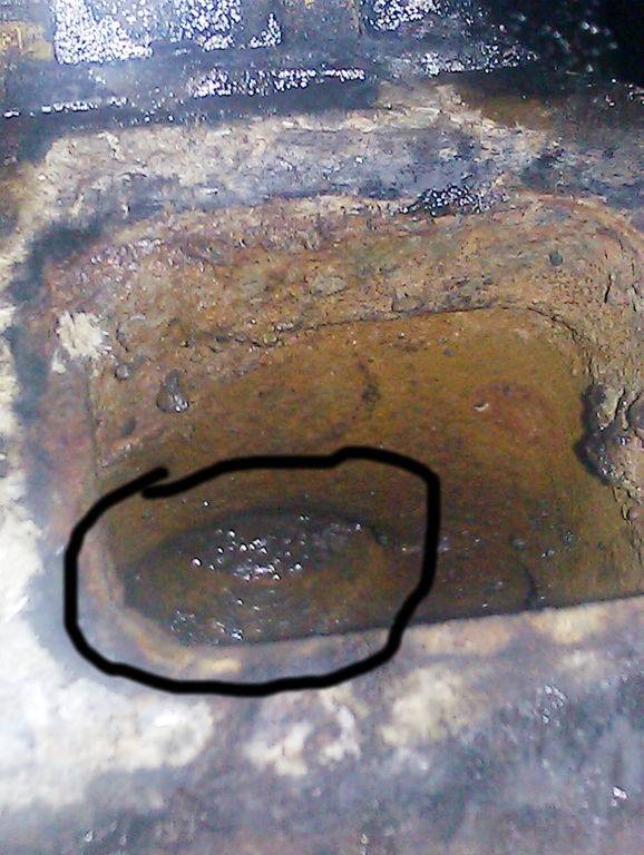

Here's a better picture of what I'm talking about specifically:
You can't see the debris, but it is plugged up, and so is the same hole on the other side. Both face inwards towards the block. Does that matter? I just don't know if they're secondary coolant passages or not.
Okay, I'm a dummy. I got some bent tip pliers crammed in there and that's definitely metal just inside of there.
If you put your finger in that opening you should feel a round or tear drop shaped hole going down into the block. Looking in horizontally you should see it all open and the top of #1 combustion chamber that the coolant flows around.
That debris is a mystery to me, I would take the head off and explore further.
As far as the flushing goes many I have taken apart will still have lots of sediment in the bottom of the block only loosened up while on an engine stand with long probing and agressive direct pressure to that area. Pulling the frost plugs gets you right in there.

I'm going to have to get a dentist's mirror and look in there... I want to believe you but what I'm feeling doesn't make any sense. It doesn't even feel like a blockage after I picked out the rest of the white crud, it just feels like a rounded-off dead end. Very strange.

Confirmed not to be a problem and not a passage of any kind. I got a tiny pick-up magnet from Harbor Freight and the surface inside there is flat and magnetic. There is a passage that goes down to the head, which is clear, but it's well below this thing. The debris I pulled out of my mystery area (I scraped at it a little with my bent pliers earlier) stuck to the magnet. It must be some kind of casting area or something that was filled in at the factory? At least I know I don't have quickcrete in half of my engine.
