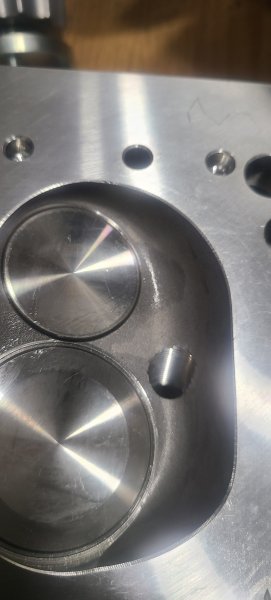

You are chasing your tail and the "Symptoms" caused by the problem. You keep talking about the pass side head does not compress the head gasket, and THAT is your problem causing to symptoms that you are chasing. Remove the head gasket and put the head on the block. If the head cannot go all the way down to the block deck, this is the problem. You need to find out what is holding it up. I have had it happen a few times with aftermarket heads where the dowel holes are not perfect and the head hangs up on them. Also, the aluminum heads are wider than the stock head IIRC, and the outer edges can protrude above the deck if the block has not been decked. If one or both of these are taller than the deck, it can hold the head up, preventing complete gasket sealing.

Well i I thought about that. So before I torqued it down again, I put a sheet of heavy 8 x 11 paper under first. Then the head ..it's tight. The paper won't slide all the way through. So has to be flat.
I installed a set of these on 2 more 360 blocks in the last 4 years with no problems. Now mind you the manufacturer process can have faults, I get that. But it's flat.

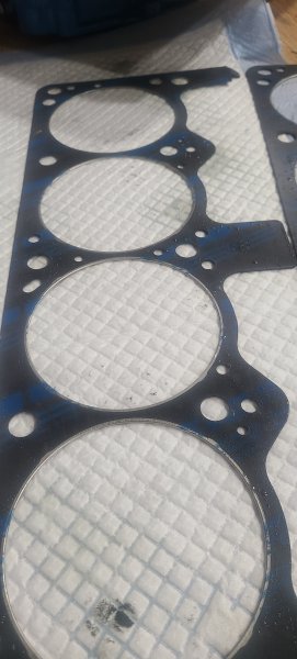

Actually both sides were wet. And this is pass head on #8. So ya..sealing.

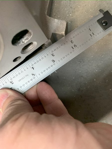

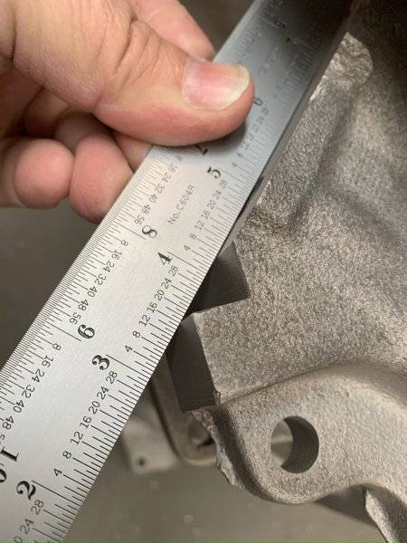

Now I'm waiting for a machinist straight edge to show up to check the deck. My cheap SS ruler isn't cutting it. It could be the deck as it's still original.

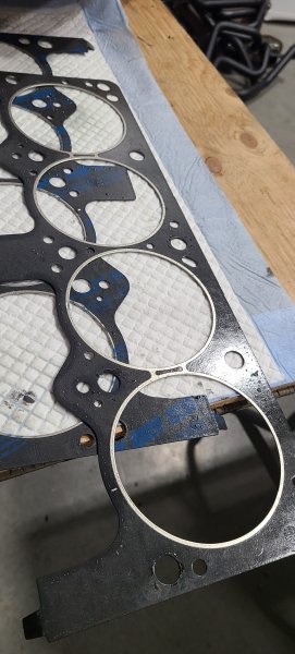

new valve and seat and was returned the next day fixed! So that I know. But both of you are correct. It's not sealing the gasket. It should be dry and it's not.
Hi..maybe this will help clear this up a bit. This head is torqued and verified all cylinders aren't leaking as I ran pressured air in each. When applied air into the coolant system, it's blowing out the #4 cam journal.

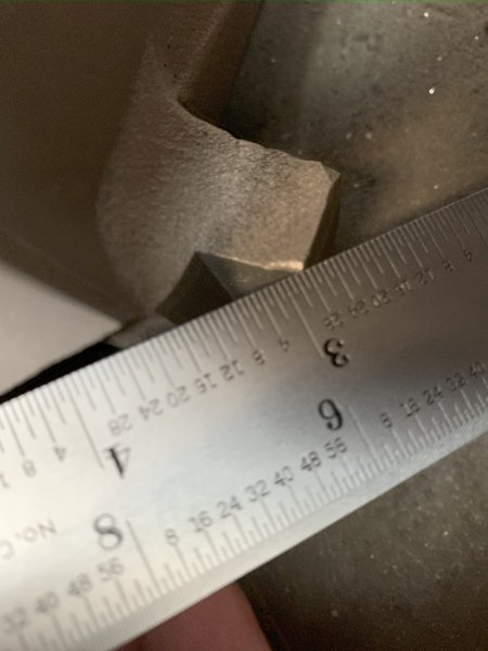

Don't forget about these 2 chunks I found. I believe they are from below the oil galleys and one broke through.
