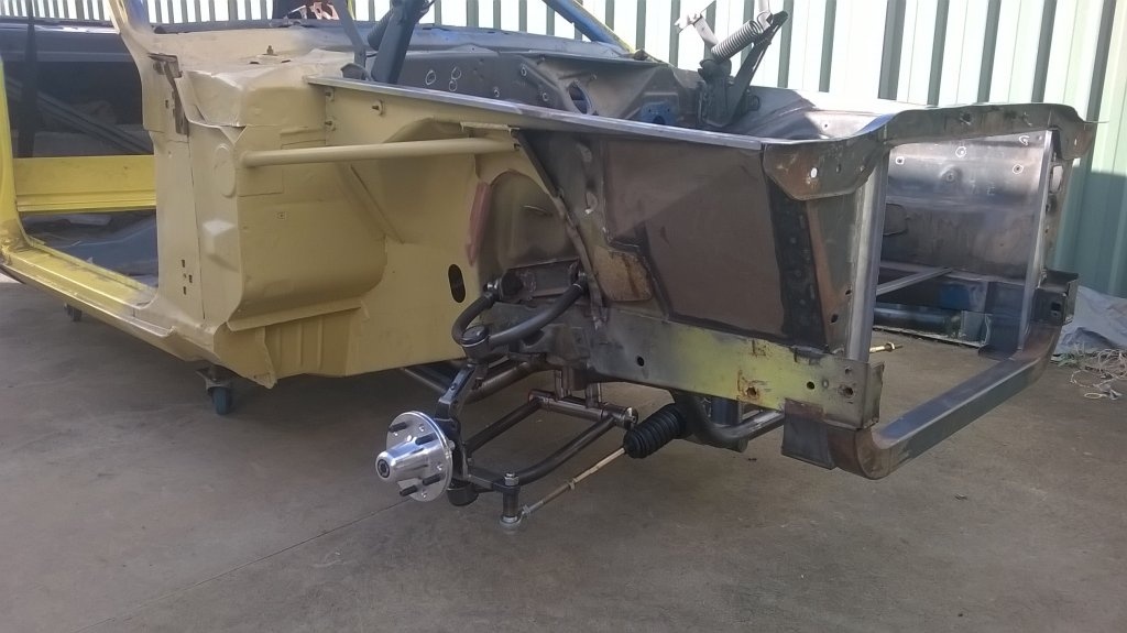

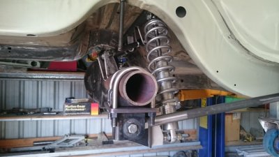

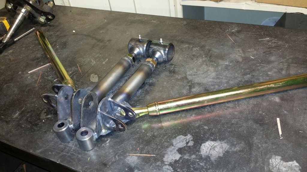

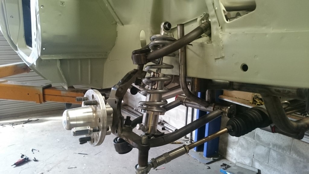

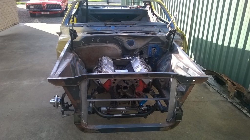

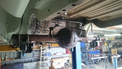

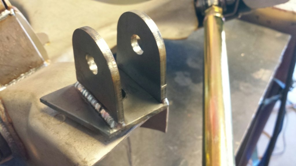

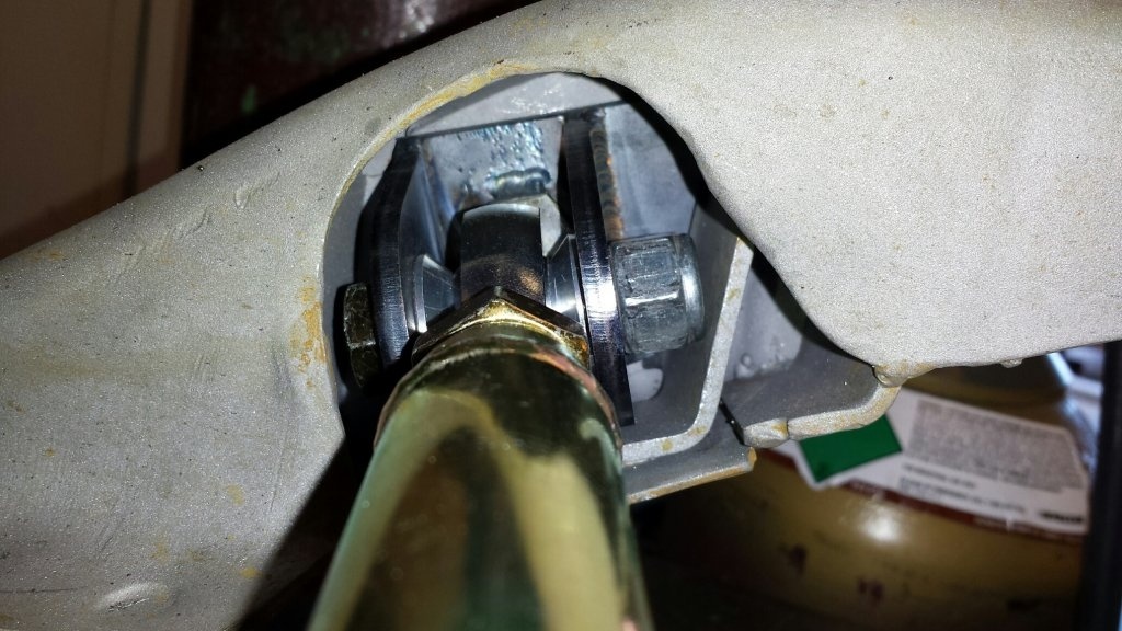

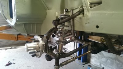

Hi there ,I have a 72 Roadrunner 505 RB ,ford Automatic Overdrive trans .I am building a front end measured of an rms ,but styled more on the control freak set up as the box section RMS one looks terrible,looks like they have just slapped it together expecially the steering rack mounts.I also copied the street lynx rear end,they have some nice pictures and tell you the measurements of the linkages. I emailed Andy Helgeson at viking shocks he told me which spring rates and shock lengths RMS uses for the front and rear end.if any one wants to know measurements and part numbers I can supply them ,but they are in metric .haven't quite finished the front end yet,the sway bar I make out of 1 1/8 4140 just heat it up around formers and leave to aircool
