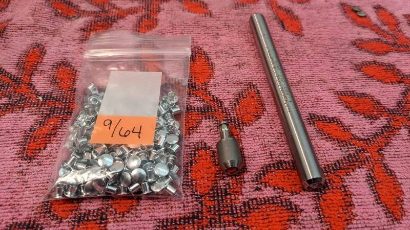

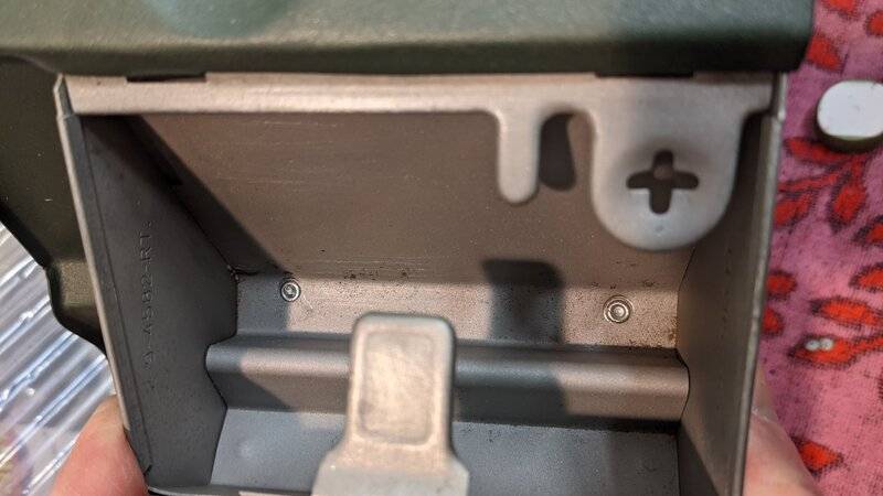

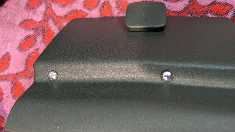

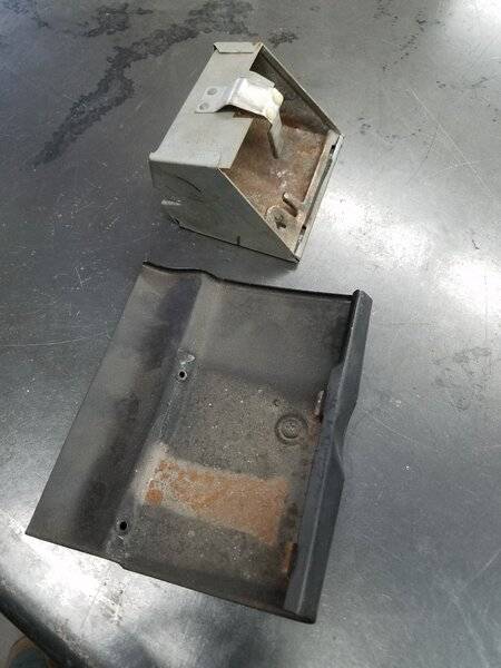

OK; so my ashtray restoration is complete. The 9/64" rivets provided by Geetex are perfect. Here are the pictures assembling and the finished product.
I drilled out the original rivets, bead blasted the ashtray door inside & out, and the inside of the ashtray. Painted the ashtray door & knob Bayou Green Metallic Suede.
I purchased the correct driver and anvil to install the rivets. It was really easy to cinch the rivets with the driver. It looks amazing!!

Bought both on Amazon, here are the descriptions; let me know if you still cannot find them, it was difficult, but these work perfectly!!
1) Squeezer DIE for Oval/Truss Head Rivets with A 7/32" /.218 Head Diameter, 1/2" Height.187 Shank Diameter.437 Shank Length. Hansen Rivet: # SQ-4-10
2) HT-174 Hand Rivet Clincher for 1/8" Diameter Tubular Rivets. Designed to BE Used in Conjunction with A Hammer to Clinch/ROLL Tubular Rivets. Hansen Rivet: #HT-174
