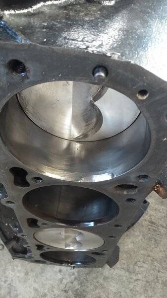

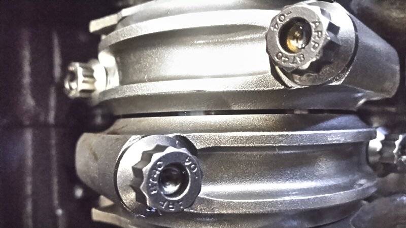

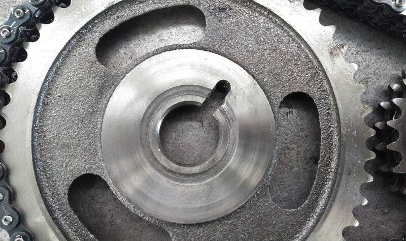

I'm throwing in the towel on this engine but wanted to share a couple more pics of this poor thing. At this point all I can do is laugh.
The tops of the cylinders were ground on, I guess for valve clearance, but on the lower side of the cylinders. At least that matches the upside down pistons. Rod side clearance is huge, over .035 on rods 7/8 and 3/4. The sides of the rods were ground on possibly for balance? .020 of endplay on the crank. I hear Taps playing.
The bore notches are above the ring so no big deal as long as a head gasket does not overhang it, the side play on those rods is pretty normal, never will be .017. The end play I cannot explain without seeing the bearing or trying a new one. The one thing I can't tell is if the chamfer on the side of the rods is facing out towards where a crank fillet would be.
There's just too many "maybes" for me to want to take the time to mess with it. Heck, if someone feels like a nice drive to Central Oregon, I'll load it in your rig for free including the Isky 505 cam & lifters that were in it and even buy you a beer/soda/ice tea.
If you Google 426 max wedge bore notches the notches are in the correct spot, lower side of the block. 440 marine gaskets have a bigger bore, but those notches look pretty small so I doubt you need them. When you build a 440, or any engine for that matter... the first thing you should do it put both heads on the block, turn it over and scratch the cylinders on the heads, mark the heads left and right, and never unshroud the heads past that. You will see big blocks have a weird shape right where he ground, so no harm. Intake side is way more important than exhaust. I have seen stupid big unshrouding on heads that can't be good for flow. I use a 8519pt felpro mark the block for notches, and the block to mark the heads. I think you can salvage this if the bores have correct clearance.
You'll have to run two high volume oil pumps to keep up with the rod spacing!
Jeez, what some people do!
Rod side clearance does not determine oil demand, bearing clearance does. The only way side clearance would increase oil demand is if you had a real narrow bearing or a ton of clearance. More side clearance is better than too little.
There are thousands of engines running
030-.050 side clearance with no issues.
