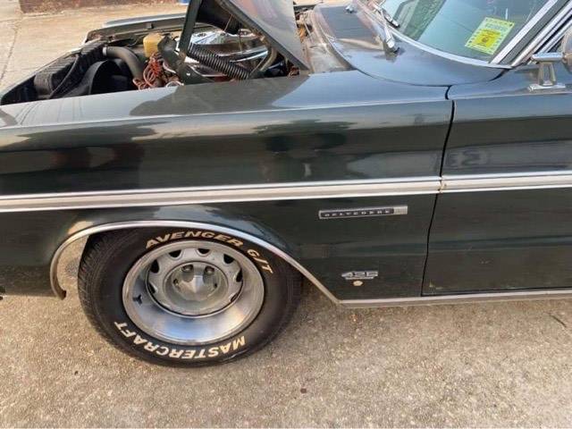

You gotta love it when a lady shows up in her fathers 67' Hemi he bought new in early 68' and kept all his life to pass down to her !!!
Pretty dang cool - reckon she's got anyone to help her maybe clean it up a little?
Normally a 67 would be a GTX... Per Galen's White book Chrysler built 1 67 Belvedere I with a 426 & a 727.
They built 5 Belvedere II's with a 426 & a 727...

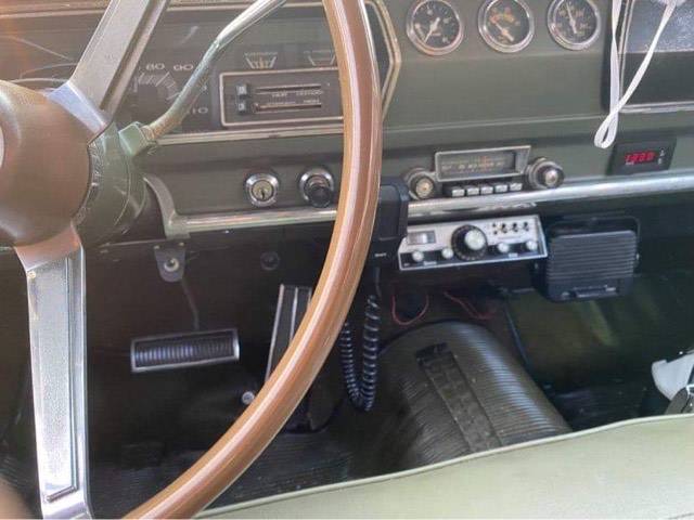

I got a good question. The speedo goes to 120. Was that standard thing for one of these?
120 speedo was standard.... GTX got the 150, not an option in the Belvedere
Another question is I thought the gold pentastar was only on the lower passenger side fender not on the drivers side.
Is that a Belvedere 1 or 2 ( not familiar with 67's )

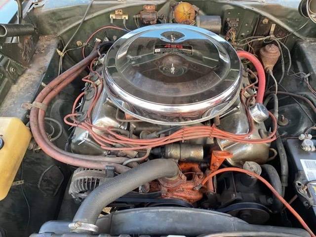

That car is a funky mix of parts. Nothing there is 1967. It’s a 1966 Belvedere II according to the side trim, emblems and door mirror. That green dash was 66 only, so is the column, wheel, shifter, etc. single master cylinder. That’s a C-body gas pedal. And then it has 1966 Satellite wheelwell and rocker trim. See how they fit together. And the super rare drivers side pentastar.

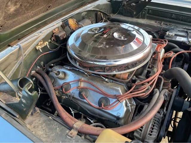

And where is the bracket on the inner fender with the horn relay and starter solenoid? They are mounted on the firewall like a non hemi car.

I don't know 66-67 well enough to tell, I know a 66 Hemi would have the relay bracket, not seeing the bracket I accepted the 67 MY as fact... Being an older Hemi swap totally makes sense, without seeing VIN/Fender Tag etc I would have more questions than answers..

Didn’t even notice the gas pedal but yeah that’s not right.

1966 Hemi insignia, and the column and cluster have some 66 like features, along with everything @R413 said. Did you get a picture of the whole car? 2 headlights or 4?
It's still great for her to bring her dad's old car out. I know it was a cool thing in the day to put gauges in the dash like that, but today I would be hunting for a dash or repairing that one. Still it has good possibilities if it's a real Hemi car.

I'm no expert, but I agree about the gas pedal, and the extra Pentastar. That Master cylinder screams out original, and makes me wonder if that would have been installed on a HEMI car from the factory. Darn sure I wouldn't rely on that with the additional HP.
Nice touch with the WEIAND valve cover screws. :)
Seems to me, some of the obvious Hemi signs need to be looked into, like vin #, data plate, trans cooler, split wiring harness on passenger valve cover. torque boxes ect.
