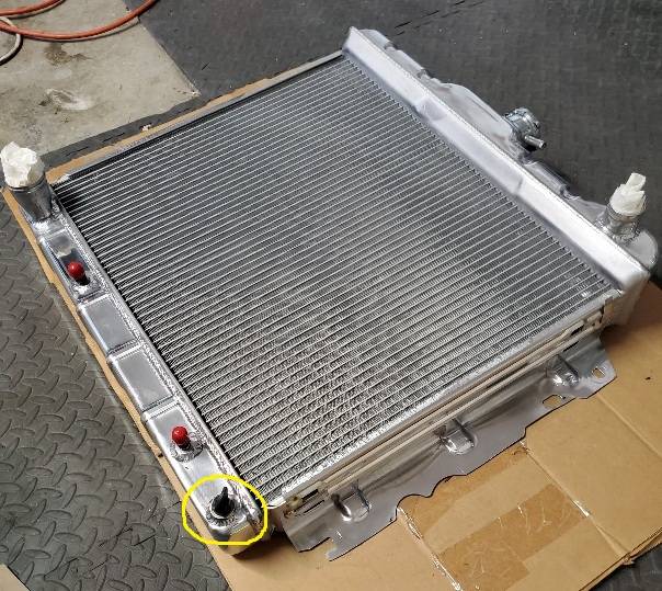

Just received my new 22" radiator for my '65 Plymouth Satellite. So far so good. fits nicely with very little mods.
Has anybody replaced that plastic drain plug on their ACC radiator or do you just leave it in? I have looked for a 7/16-20 petcock for it but no luck so far. the original valve from the stock radiator looks to be NPT thread and I don't want to take a chase on striping the new radiator threads.
Any thoughts or suggestions would be appreciated. - Thanks
