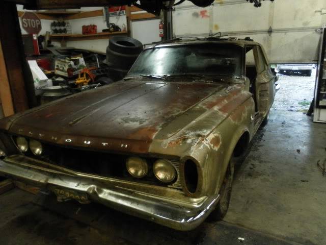

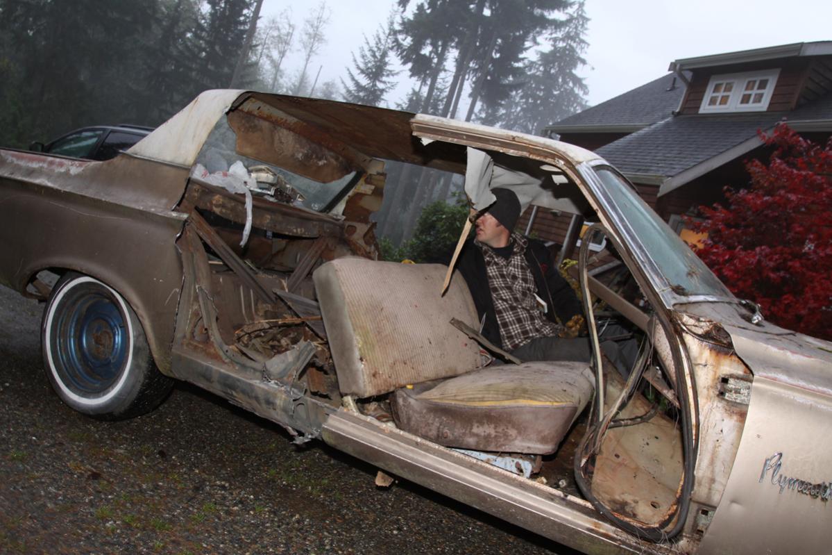

Successful trip to see our friends on Vashon Island this past weekend where we annihilated what I consider to be a quite rare car. Even though this car was severely gone, it still made me feel guilty to destroy a factory light weight '63 Plymouth. It was never coming back before we got to it but we really sealed the deal. It did give up it's doors and entire B-pillar assy with side glass for our two door post conversion. We also dropped off our '65 big block 727 for a complete overhaul from their resident guru that we will pick up in the Spring. We now have pretty much all of the pieces in place so we just need to put it all together. A few hundred hours should have it looking pretty good, I figure. Then I want to make it run and finally make it look really bad-***. Realistically, next Winter for that bit.

Nice score with the parts/donor cars Pat, selling off the leftovers will help fund the project to some extent.
Not too much to sell off really, the '63 is still a parts car for those guys so I didn't take anything that wasn't necessary, the van offered up some descent headlight rings and tail lights and I still have quite a bit of '64 Plymouth stuff from the Belvedere wagon that we chopped. I just need time to sort it and I hate dealing with e-bay as a seller.
Yeah buddy...that was a fun weekend! How did you get me in the shot? I'm never in the photo.

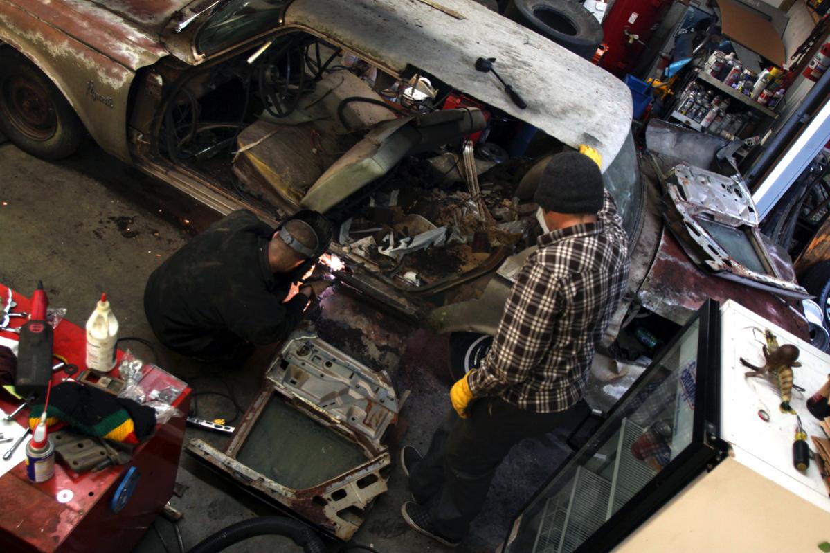

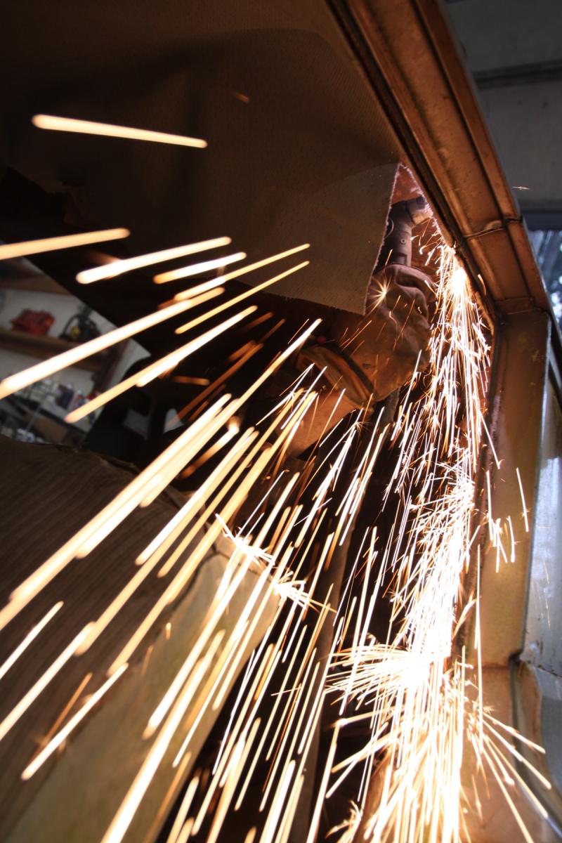

More photos
Here are a few more shots of the Plymouth tear down.
