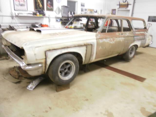

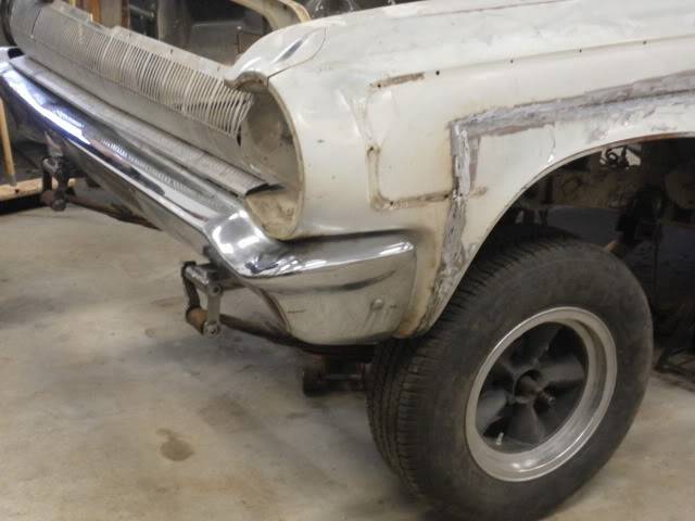

Fender modification is half done and looks great, if you ask me. You can see more pics and read more about it on the build blog shown below.

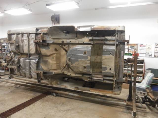

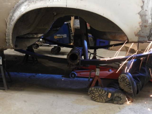

I got probably 95% of the body stitched, ground and flap wheeled. I'm amazed at the amount of lead from the factory in the rear corners. Over 1/4" in spots. Still lots of welding to go on the interior and underside though. We then got our rear leaf spring relocation done to accept those 10" slicks.

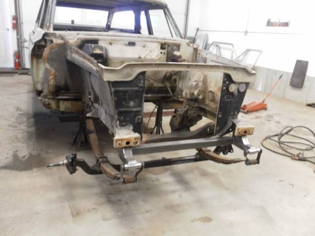

Front spring mounts competed and axle hung in place to get the feel for the new spindle height. We also added a new forward cross member and notched our front bumper to clearance the new mounts.

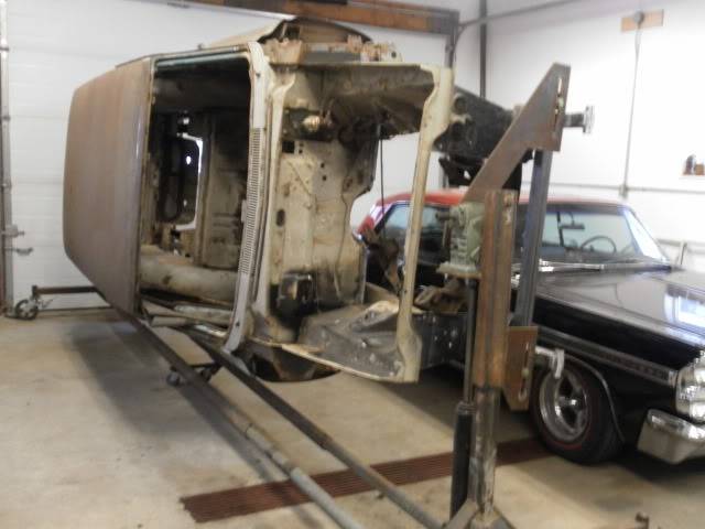

And finally stripped everything off and got the body on the rotisserie. This officially signifies stage 2 of the operation.
