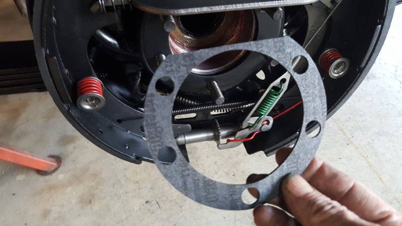

Here's the gaskets.
Steel gasket...
Then backing plate. Then foam gasket.

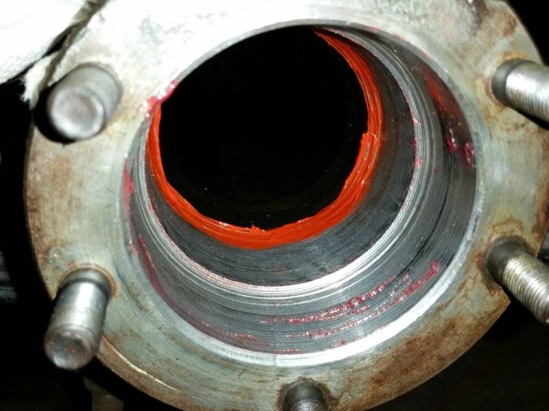

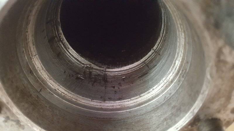

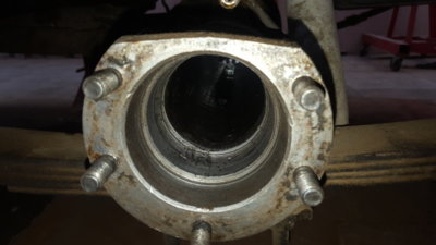

I removed the 2 seals, found scratches and gouges in the axle housing, I don't know if that was me or the prev owner( I used a hammer and chisel not a puller to remove the seal). Did not smooth or sand the area just smeared some mix of PC11 in the axle housing and the O.D of the seals, installed them( I measured how far the seal should be in so it seats on the exact point on axle).

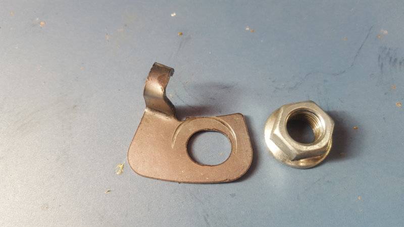

Axle end play adjusted, lock found missing, bought one from eBay, now I have to wait 10 days till it gets here. I believe it is not recommended to drive the car with the lock not installed, I noticed that when I removed the axle the end play was far out.
here are 2 pics of the axle housing after removing the shaft.
You could fabricate a lock tab to speed up the process.

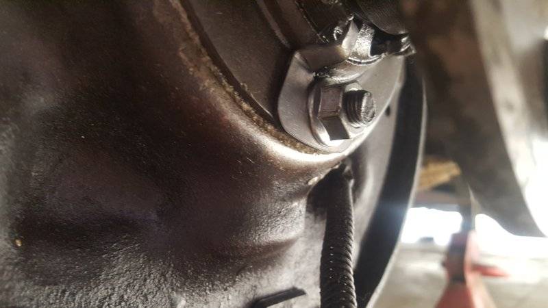

I got the lock I bought from eBay 20 Jun, installed it, just waiting for drive test to see if the seal still leaking.
Nope, shouldn't drive it without the lock...and I would smooth out the gouges especially if they have sharp edges sticking up. I have a buddy that uses the end of the axle to pry the seals out....I like to use a long punch and put a hole in it and then pry it out. Either way works.
View attachment 623162 View attachment 623163
How did the drive test go? I just finished up mine, no leaks so far... You did have some scoring of the tube shaft where the seal goes. That may be your problem. If it still leaks, Like cranky said smooth it out best you can. Look how I applied sealer inside the tube shaft, it may help.

I thought the seal I applied (PC11) was enough to cover the scratches and gouges. All axles I saw in the forum were nice and smooth not like mine.
I really don't know what is wrong, the seal is correct and fits tight on axle shaft and in the tube.
