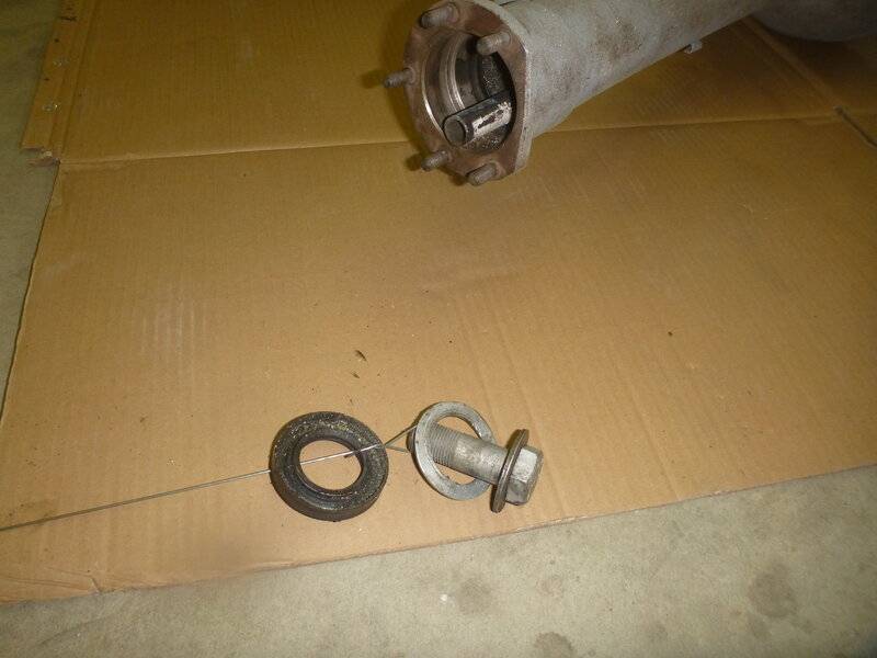

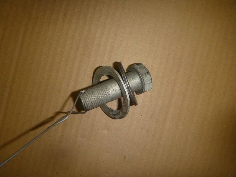

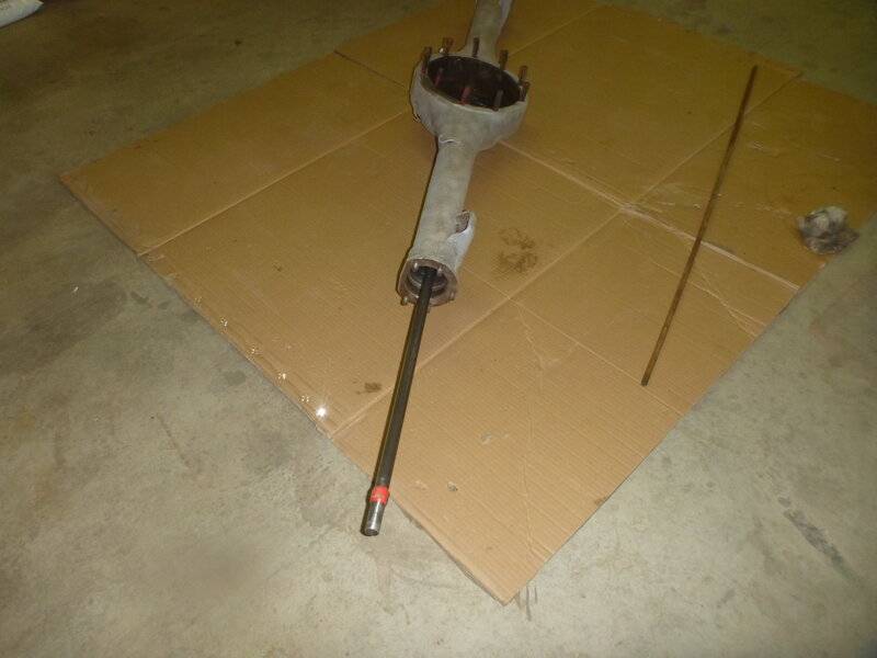

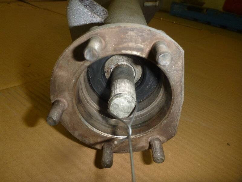

Easy as one two three if you've got the pumpkin out..

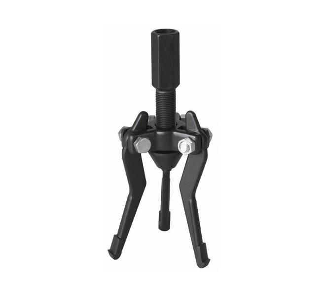

Try an internal puller attachment for your slide hammer. Plus, make sure that your slide hammer is large enough. I have a 2 1/2 LB for simple tasks and a 5 LB for stubborn pulls.
Have a 2 1/2 lb & have a puller like that. Just not sure it has a way to attach the slide hammer. Havent used the puller for a while.

Mine threads on to the end of the hammer. I have the OTC set that comes with 8 or 9 different pullers ranging from a pilot bearing puller all the way up to hub pullers and inner and outer bearing pullers.

No special tool needed for removal of seal the answer is in your hand
