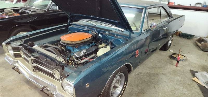

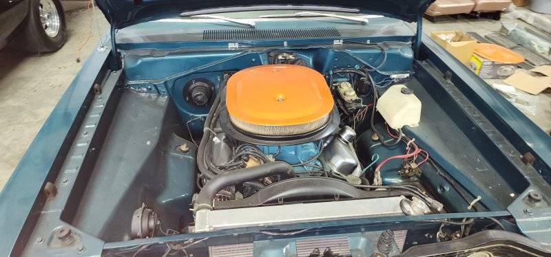

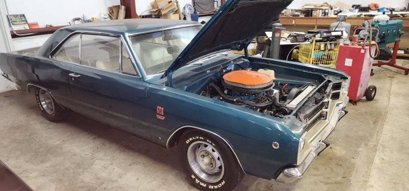

My 68 383 Dart is now a 400 based 451 stroker with the Eldebrock low deck 6bbl intake. It fits under the stock hood. No dyno runs with the 4bbl or the 6bbl setup, but seat of the pants tells me there is no comparison. I have run both on this car and now have a convertor (not installed yet) to make the 6bbl manageable on the street.
