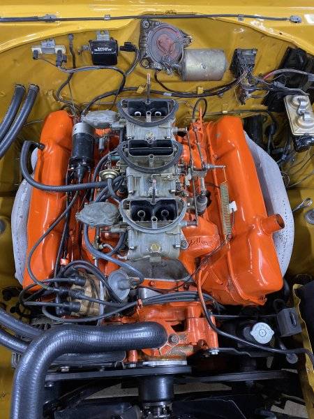

What are the benefits of a 6 pack over a 4 barrel? I found a 6 pack setup complete for $800. But I already have a 850 tquad and can buy an intake for a couple hundred. Besides the obvious cost advantage to the 4 bbl, what's the advantages of a 6 pack? Are the 3 smaller carbs bigger then the 1 big 4 barrel? And what's the technology / idea behind the 6 pack?
1350 CFM, total. 500 CFM each for the outbound carbs and 350 for the center carb.
The 6 pack was 15 hp better than the 4bbl in factory trim. Many people think the increase is because of additional air flow of the 6 pack.
The 4bbl intake is a low rise intake, whereas the 6 pack is a true high rise design. In my opinion, most, if not all, of the additional 15 hp came from a better designed free flowing intake.
