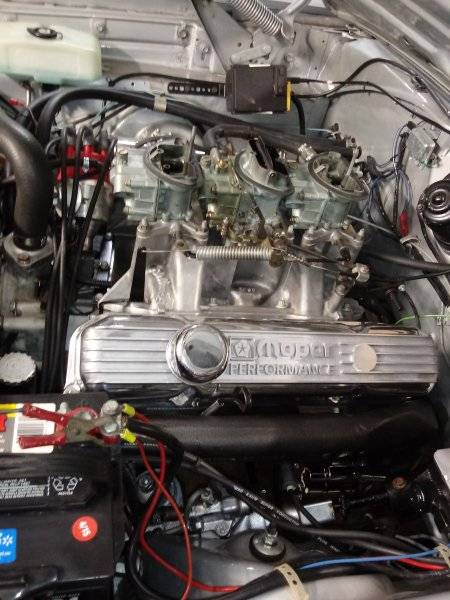

Six pack setup with Manual Transmission
6 pack had a fast idle solinoid from the factory also
I am still putting my car together but it is running and moving on the engine and have not had any troubles with out one
you dont need the solenoid ,my Bee with 4 speed

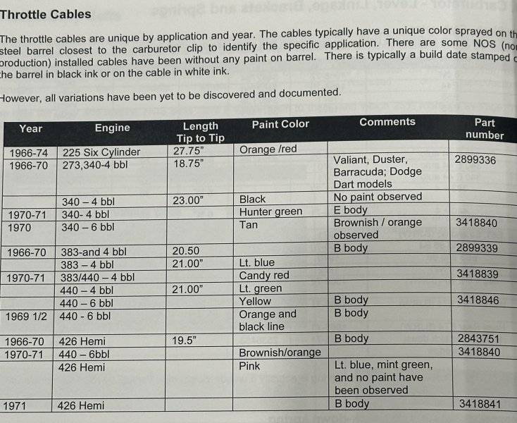

Good luck finding that solinoid! You don’t really need it! As far as special linkage, nothing needed for a standard equipped vehicle other than the throttle cable

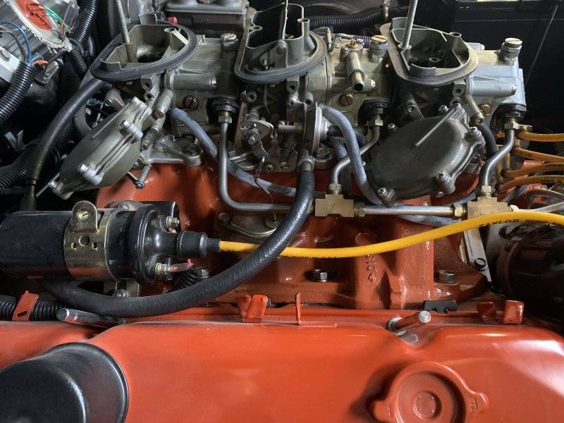

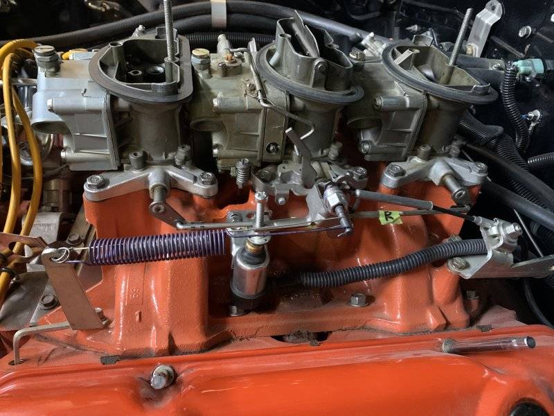

Attaached are fresh pictures of my 1970 Cuda 440-6 with manual transmission. I realize this is not a B body, but thought it could help. The factory spring is a single one and is purple. I added a second spring for backup. You can see this in the center of the purple spring. The idle solenoid is installed but is not used. Even with a slight performance cam, I was able to tune the car to idle at about 800 rpm. So not run on and eliminated the solenoid usage. Hope this helps.
great help. thanks.

Ordered a new throttle cable from Imperial a couple weeks ago, i guess they make them to order. will be another 2-3 weeks.
