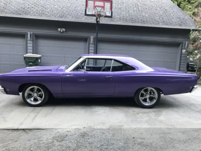

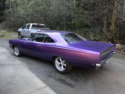

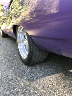

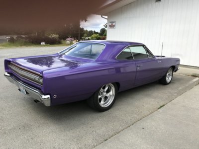

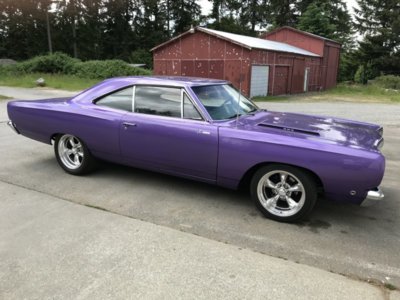

I went with the Hotchkis TVS without the rear leafs, and sub-frame connectors, and keeper the stock torsion bars for will probably update in the future. All new Hotchkis non adjustable shocks, Wheels are American Torque Thrust II, 10 inch in back with 305/40/18 tire, and front are 9 or 9.5 with 255/40/17.

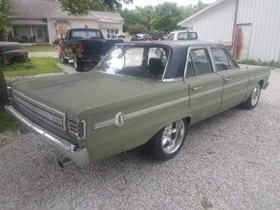

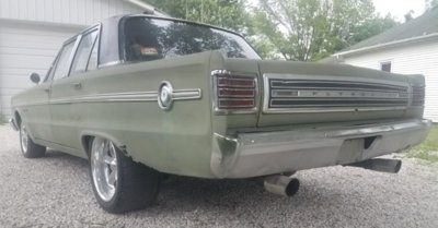

I just bought this car, and it is a little ruff around the edges but I sold my last Belvedere almost 5 years ago, have missed it terribly and could afford this one. Took these wheels off my Rambler project. Front are 17x7 3.75" back space and rear are 17x10 5.75" back space. Tight fit, but massage things a little and made them fit.

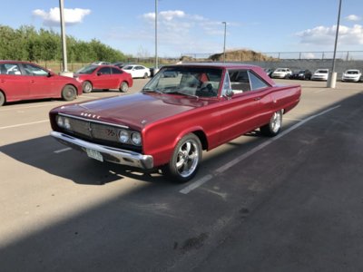

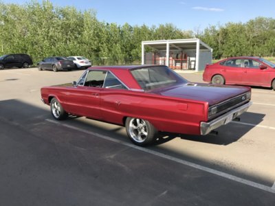

Here's a couple of recent pix of my Year One aluminum Rallye wheels 9" wide 5" backspace (the way they come) with my 2 year old Toyo Proxes TQ drag radials 315/35/17s. Totally stock rear suspension other than racing shocks that have no affect on fit.
View attachment 610363 View attachment 610364 View attachment 610365
What is the back spacing on both front and rear Smoothie?
That's pretty much the combo I want to go with on my 68.
