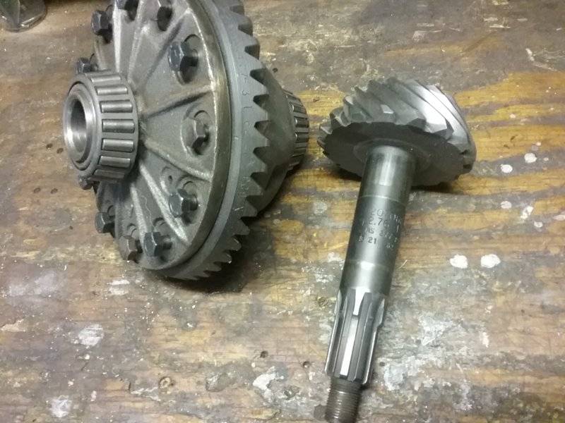

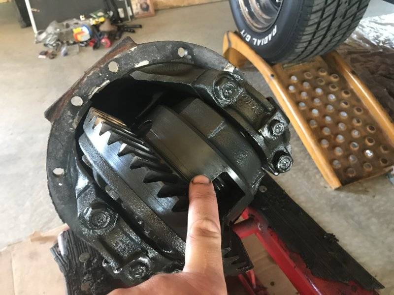

I have the 3rd member off as we speak to replace U-Joints and a tiny leak at 3rd member. Now is a great time to ask questions. Perhaps I can get a hold of a 2.76 or 3.23 at a reasonable price.
