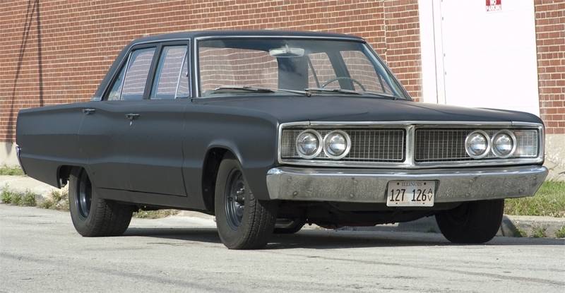

Here's a pic of my baby. My "Coroner"
Quite the sleeper.
Those tires fit without cutting?
Yessir, It's got a mini tub in the back. Room for about another 1 1/2 inches wider if I want. :)
