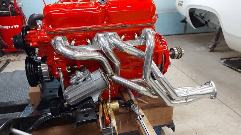

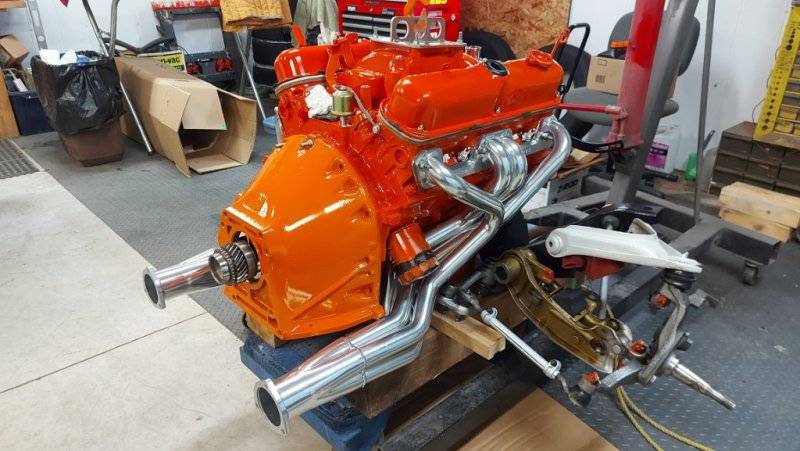

Here are Doug's headers mounted on the small block.
