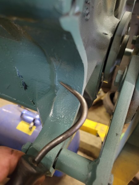

Working on a 1970 Superbird. I had the motor and transmission rebuilt. Owner wanted headers so I installed a mini starter from Summit. Fired the engine to break in the cam but had to shut it down due to the starter bendix not returning, stayed engaged with the flywheel/torque converter. I have checked a multitude of things but can't figure out why the starter gear will not return. Ordered another starter from Summit thinking it was faulty, no, same problem. Installed original 1970 starter, same problem. New Converter seems to be correct, 130 teeth. Any suggestions?

Usually the problem is at the u in the block not allowing the starter to sit flat and proper.
Grind it out with a die grinder.

The dowels are in the block. Cleaned up the U area with a grinder. I think the tin seal plate that you are referring to is the plate that goes between the starter and the bell housing and yes it is in there. The relay is releasing. When you engage the starter with the flywheel, the bendix will return like 1 out of 5 times. It is like the teeth on the flywheel aren't correct or something.

How do you make an adjustment between the flywheel and the starter? The nose of the starter fits back in the hole in the bell housing and two bolts for the starter. I even elongated the mounting holes in the starter a little to see if that would help but it didn't.
