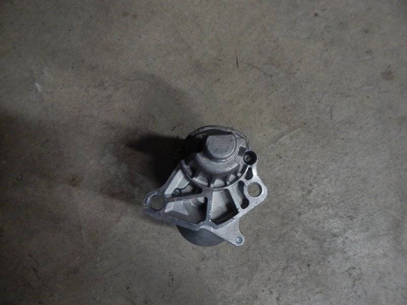

Post up a link to the starter you bought from Summit please.

Show us the starter, and a picture of it if possible. Let's see if there are any contact witness marks on the teeth or the frame of the starter.

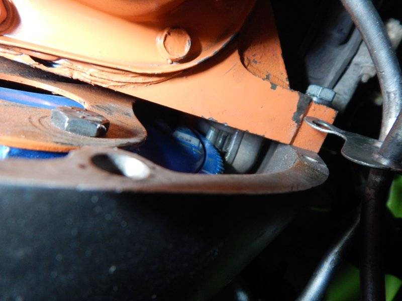

Pics,,, maybe a measurement of distance from the gear to the trans flange/ bellhousing

New member and not real good with a computer. The ring gear at the bottom of the bell housing is only about 1/4" from gear to housing. Converter seems to measure 11.5" with 130 teeth. Does that seem correct?
Is that tooth damage I can see in on the ring gear?
Was there any play with the bolts holding the starter loosened off? There should be enough to move it around some.
