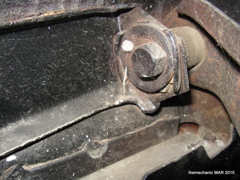

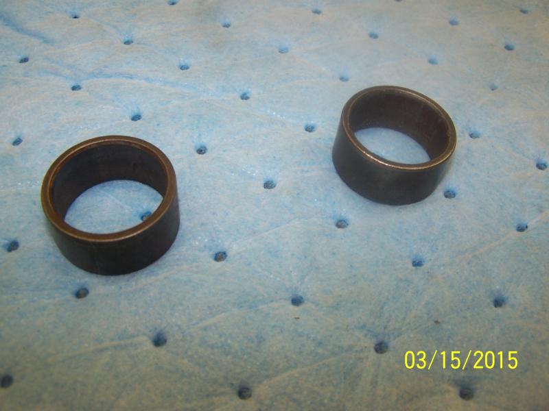

Yup. That is where they go. I don't remember seeing them on other cars I have restored but they were on my 68 Charger as well. Here is a pic of mine. I plan on putting them back on when I press in new bushings. 100_6865.jpg
The FSM said the spacers were used on Darts with 10 inch front brakes, Coronets, police and taxis. I did not see the reference to any other Mopars.

I don't know what the purpose was for the spacers. Must be for added stiffness somewhere. It is funny that the C body cars didn't have them. It seems like if some of the B Bodies need them, the C's would need them more. Don't matter to me though, They were on my 68 Charger so they are going back on for whatever good they do.
Still confused about the exact location. Do they go between the control arm and the bushing. Thanks guys

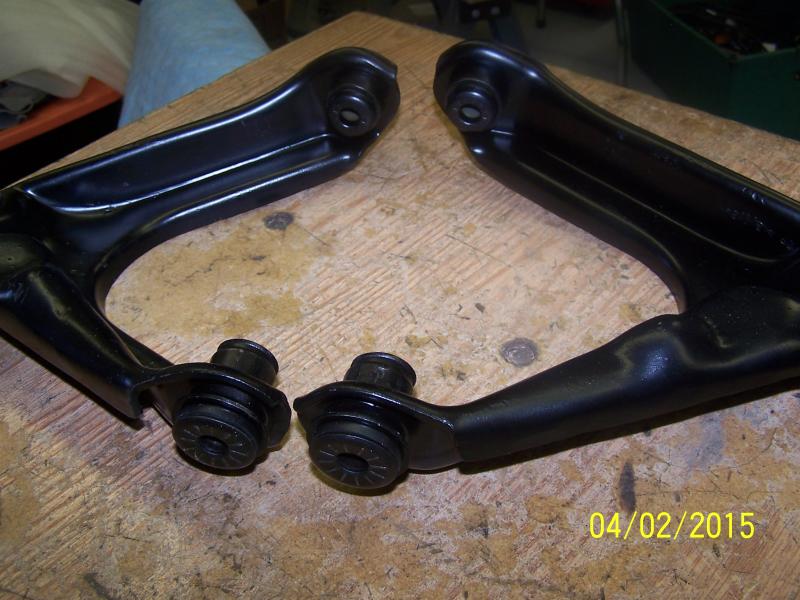

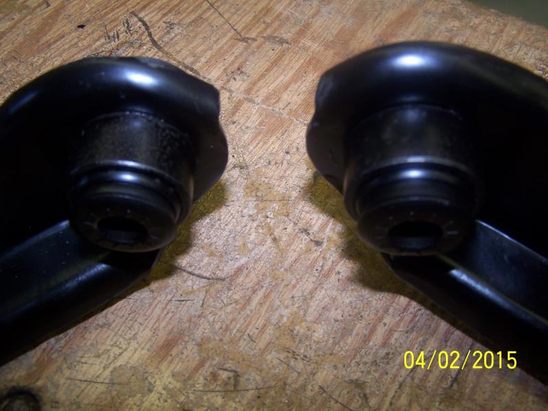

I have not seen them before either until I started dis assembly on my 68 Charger. It is a 383 auto car so not what I would call "heavy duty". Anyway, I just pressed them back on with new bushings yesterday. Here are a couple pics. They go on the rear bushing on both sides.

I have found them on both sides of the upper control arm.
