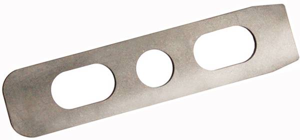

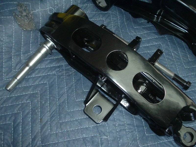

The lower control arm is typically strengthened with a stiffening plate, and that’s usually good enough for most for driving.

On these suspensions, the "load" is on the LCA. The UCA is only a follower. Thus, usually the LCA bushings get worn. Recommend replace the bushing and add the ^^ stiffener on the LCA. If UCA's are desired, recommend the non-heim joint tubular type which will give you better positive caster. I concur with post #2 ^^ on all counts.

Thanks...how does the stiffening plate install? Looks like a weld-on piece?

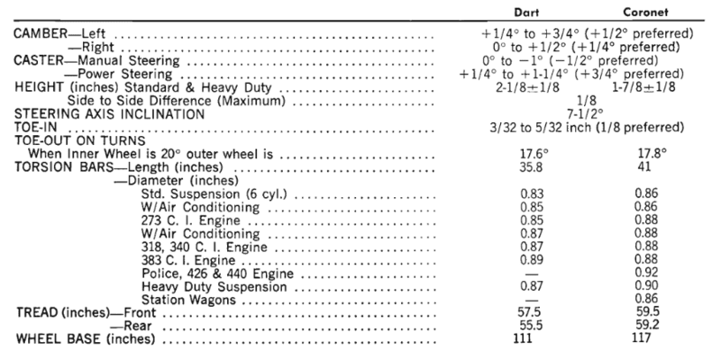

I was able to get 5 degrees of positive caster with STOCK upper control arms with Moog K-7103 offset bushings. 5 degrees is excellent. These cars were built at a time of the inferior Bias Ply tires. The stock alignment specs:
Pathetic! Manual steering with negative caster settings? Power with a meager 3/4 degree???
No.

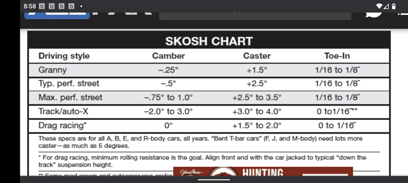

If you want the car to steer and handle more like a modern car, you need decent radial tires and a better alignment.
This chart isn't bad:
But you will like more caster.

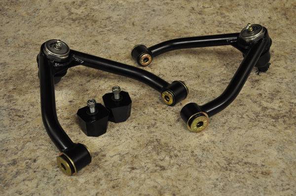

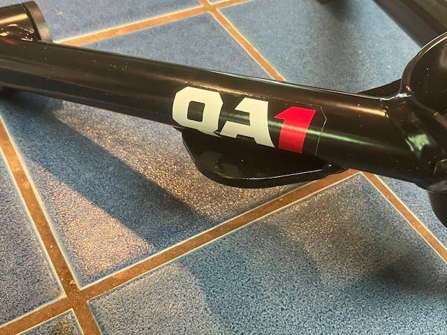

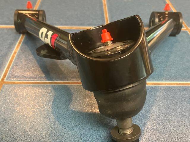

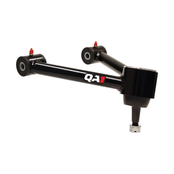

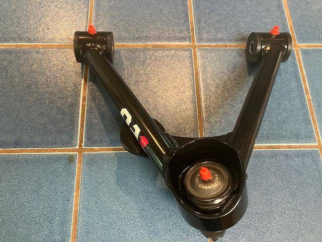

I just switched to QA 1 tubular arms that look like this:

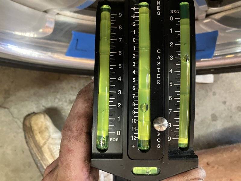

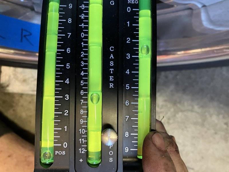

Here are a couple of caster readings I got so far. LEFT side:
RIGHT side...it is NOT maxxed out, I was able to get it to 8 1/2 degrees too, this is dialed back a little.
You can still get great numbers with the stock UCAs but these QA 1 arms were advertised to give 3 additional degrees of caster and they DO.
No.
That’s great!! Are they an easy install? Like two bolts and the ball joint? I’ve never done them before.
The aftermarket QA 1 upper control arms are an easy swap.
I must repeat though...They add 3 degrees of caster over stock control arms. A stock arm with offset bushings is a LOT cheaper. The QA 1 arms may be overkill for a car that is just a cruiser.
Hey...I have no kids and I love to tinker so sometimes I spend money on stuff that isn't necessary. Not everyone is as irresponsible!
I have PST tubular UCAs on the Coronet and Moog offset bushings on the Dart. Both work, but I liked the PST's because they came with new ball joints. Not a hard R&R. From inside the engine bay, take a pic of the alignment dowels before starting, so you can replicate their orientation with the new UCAs.

Thanks for all the info!! I'm going with the QA1 upper control arms (part number 52305). For the lowers, QA1 makes a set (part number 52308) but I am confirming they will work with my 1968 Super Bee with factory sway bar.
