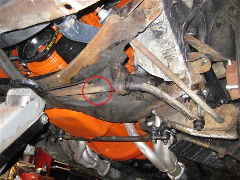

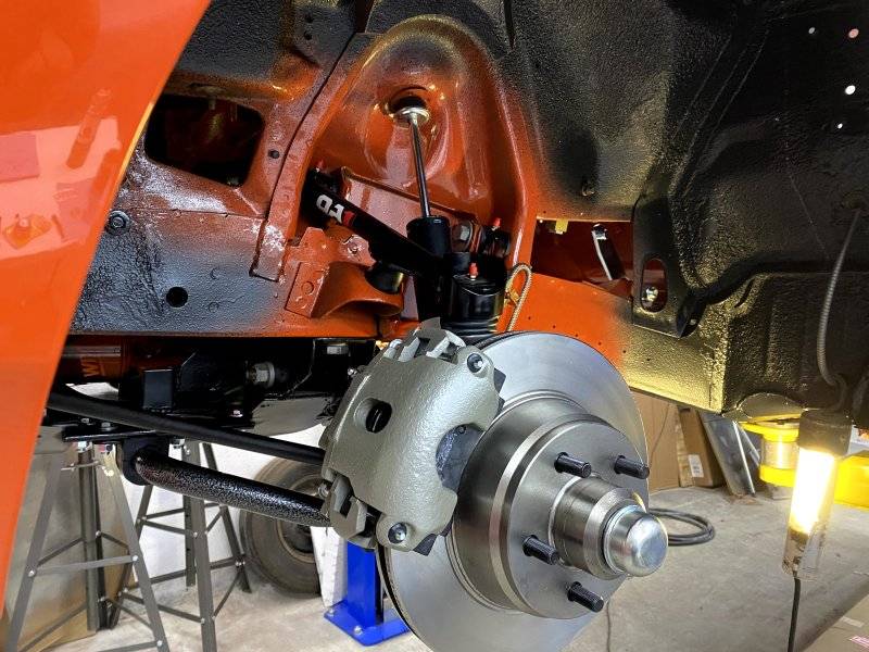

Look at your K-Frame. It should be hollow where you would normally jack it up. It will also have notches where the sway bar passes under as circled in the pic below. You can see the lower control arm and tabs as well. Second pic is a Hellwig bar installed in the factory location.
