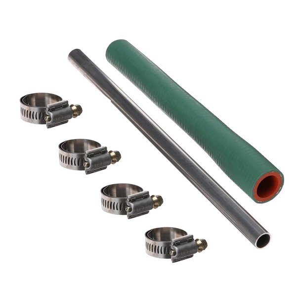

I ran one and ended up going through a couple of cables. I ended up buying green catalytic converter hose to slide over it and then covered that with DEI heat shield. I also used a bracket on the transmission housing to keep it away from the header.

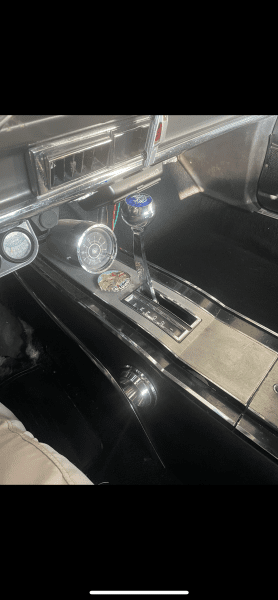

There was another guy on here I posted on a while back but never got to taking pictures..not sure if it’s the same for yours, but in my 67 charger with a 727 auto I mounted a quicksilver to the existing shifter linkage. Didn’t use the cable and it sits right in the factory plate. Just bent up a couple brackets. Looks great to me and haven’t had any issues with it

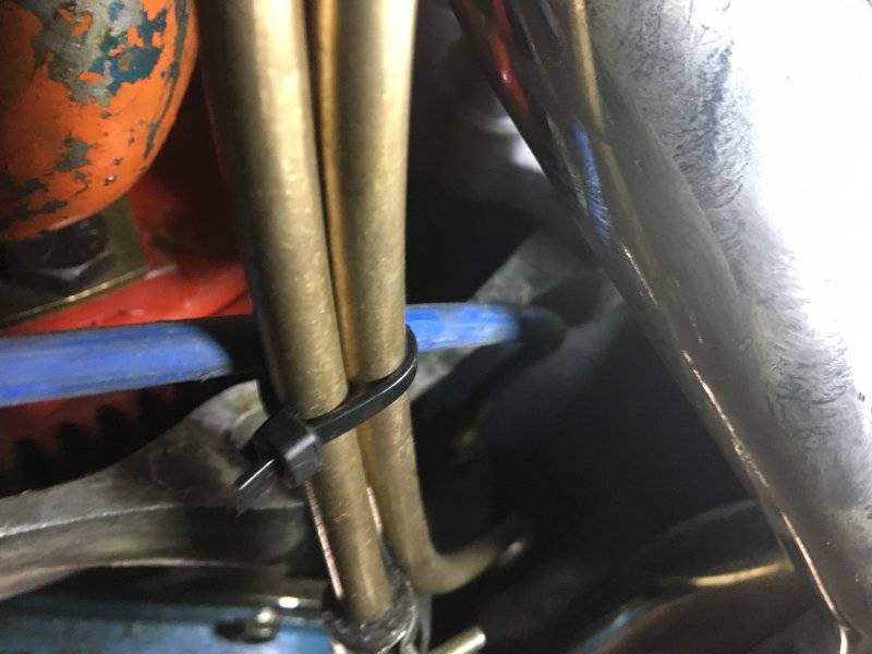

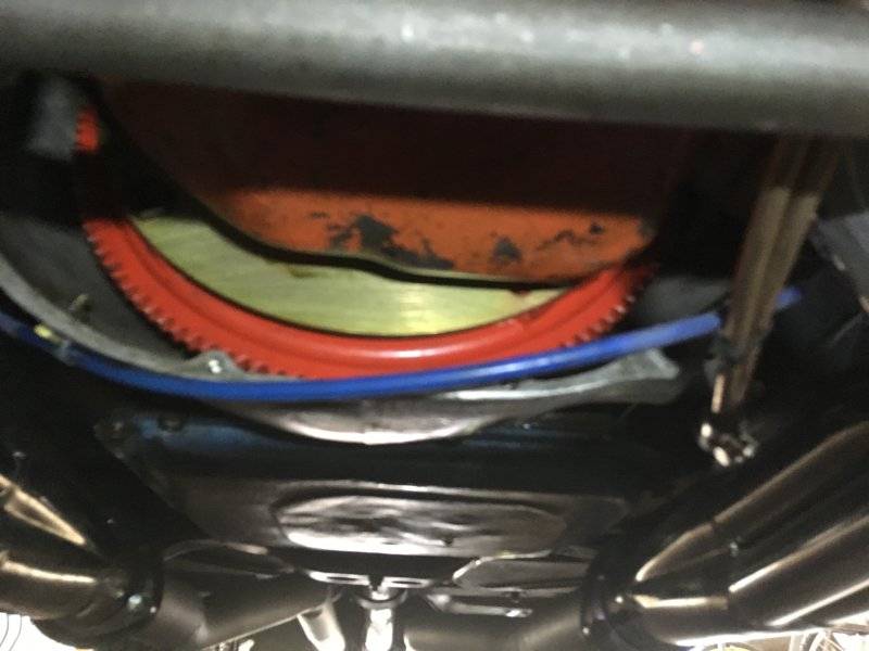

Here is my 67. I put the shifter where it worked well with seat position, but you'll have to mock it up to work in the factory console slot

This is the catalytic converter hose I used from summit's website. It is just high temperature hose, and possibly overkill, however, I ran that set up in a big block A body for years without melting another cable.
