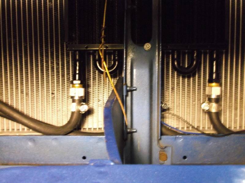

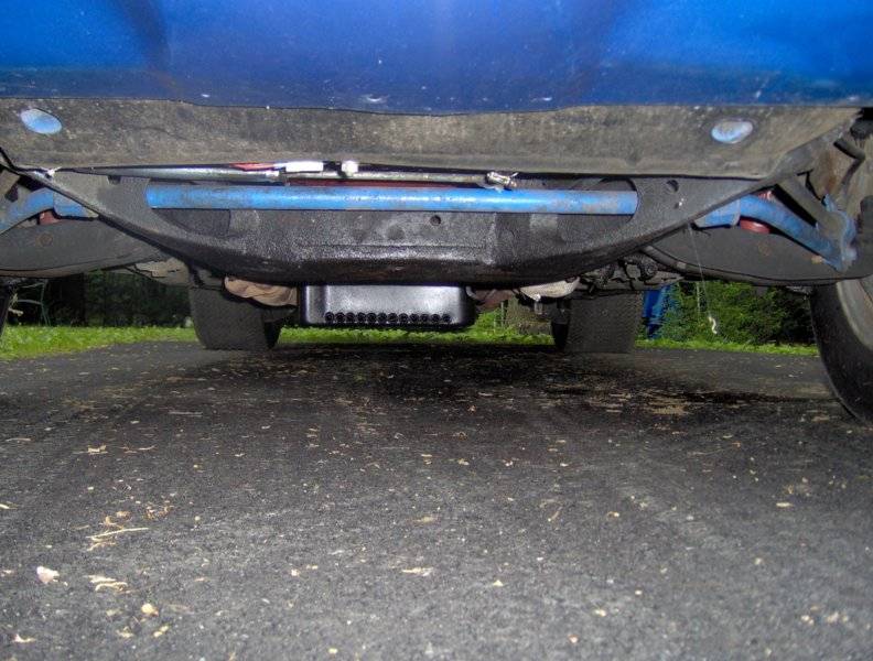

Although my converter is nearly stock, don't know the stall, it has a manual reverse B&M shifter and was a former race car. After conferring with several trans shops about trans cooling, they all said to keep it as cool as you can. So in addition to a dual oil and trans cooler in front of the radiator, I installed a Derale deep trans pan with "turbo" tubes running through it. The pan adds 4 to 5 quarts to system and has a temperature bung and drain plug as well. I Installed a B&M gauge to monitor temps and it stays really cool, all the time. Only registers when in traffic on hot days. See attached pics.

Sorry for the delay, I am at work, hee hee. All they are is tubes with a twisted band of metal inside of them that causes the air passing through to spiral. It is supposed to make the cooling (heat transfer) more efficient. Just like a radiator, the fins contact the tube walls extracting more heat. The tubes are completely surrounded by trans fluid. It works quite well. I am sure I've seen something like them used on something else but I don't recall at the moment. I have seen similar deep trans pans with tubes run through them, but without the internal deflection, just straight through. Depending on the vehicle the pan is used in, ground clearance could be an issue. I took that picture from near ground level looking up so it appears to hang lower than it really does. When I see guys with deep oil pans hanging down I wander how often they bottom out ruining everything, especially when the car sits really low to start with.
You better be careful with outdoor parking I think the Mud daubers are eyeing that pan for nesting!

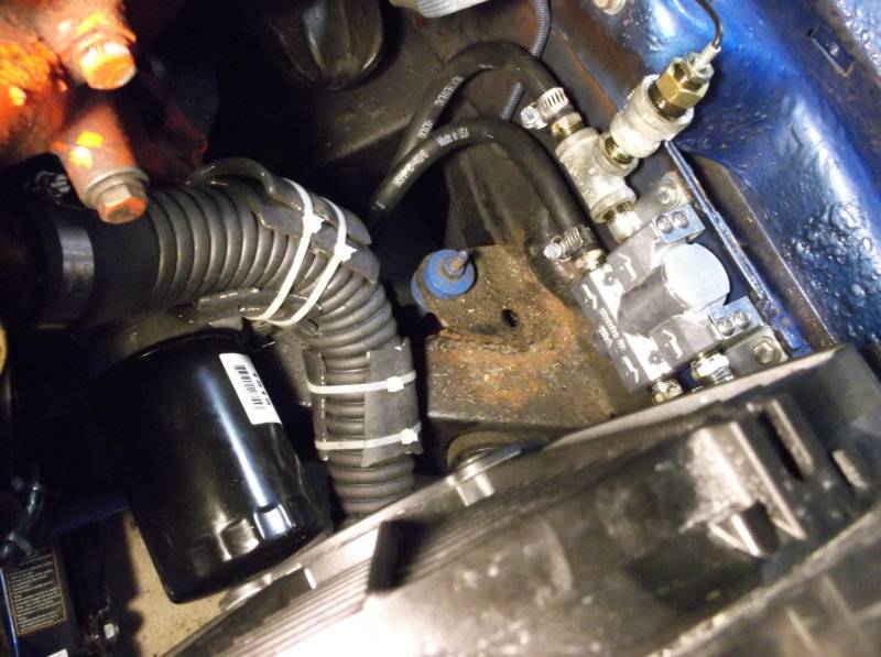

What is going on with your lower radiator hose?
Mike
I strapped some spare rubber hose around it to prevent chafing under hard acceleration! It ain't pretty but then neither am I ! It wasn't necessary until I installed the oil filter adapter for the controller and cooler. The filter got pushed out further forward but thankfully I can still use a full size filter. I still don't know how much more capacity is now in the oil system. At least another quart I am guessing.
