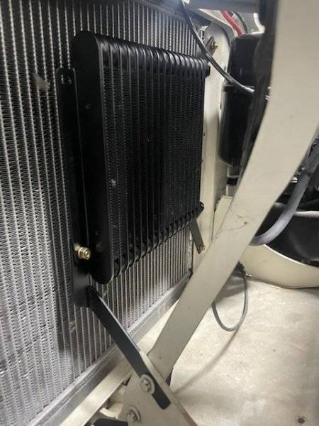

I have a 1965 Plymouth Belvedere II with a 440 engine. I am told the car was originally build for drag strip duty by a father and son. The son lost interest and the car was sold as is. The motor is a 440 and is quite healthy, while the transmission is a 727 with a cheater reverse valve body in it. The car is only driven on the street now and while it's capable of setting the tires on fire, it isn't driven that much or that hard.
It came with a transmission cooler mounted in front of the radiator which blocks a significant area of the radiator. I am fighting cooling issues and have changed thermostats, put an electric pusher fan on it and still it heats up.
My thinking is, the transmission cooler is blocking enough of the radiator that it's causing the engine to run hot.
My question is, is the transmission cooler really needed seeing how it's not on the drag strip and it's not driven hard when I take it out.

You may be able to switch coolers to a different size & design and mount it on the cool area of the radiator ( down near the lower hose ).

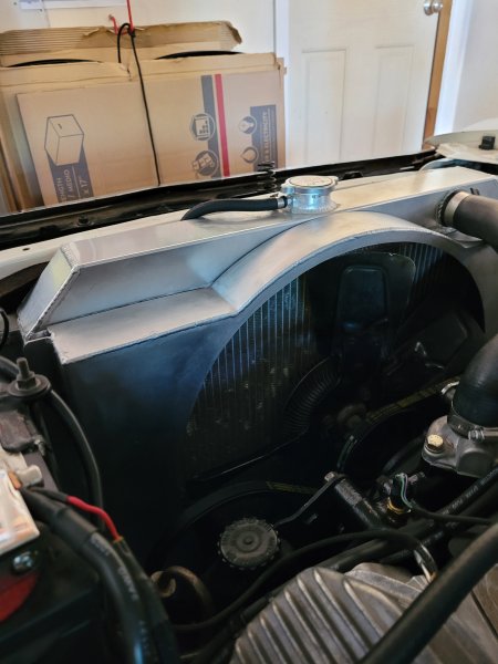

I had a custom shroud made for my 440 and its been fantastic, and my trans cooler is up high and almost touching the radiator.

Picture of the radiator in the car. Most have low fin count and can't get rid of heat. The engine holds more coolant on a 22" radiator than the radiator, so moving the coolant faster is not helping, just keeping it in the block longer.
Need tight fin count like the aluminum one pictured, lot of cheaper reproduced brass are cheaper because they use less material with loosely woven fins, this no heat transfer to the air.
