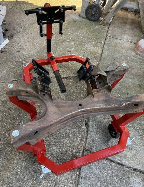

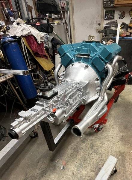

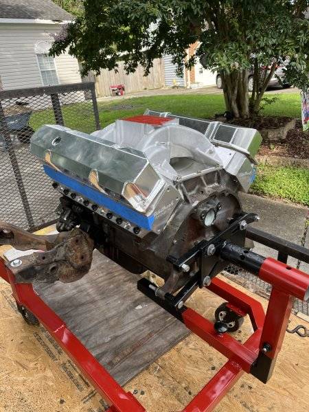

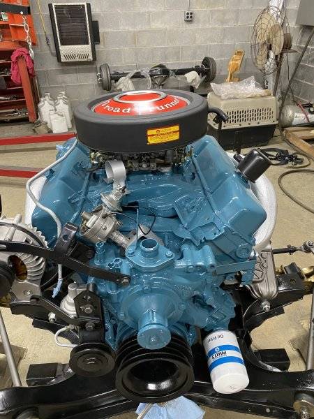

So I am closing in on the finish line on my assembly of the suspension, engine, and transmission. I am considering rigging a radiator in front and putting a short exhaust on it and doing the break in with it on the dolly. Anybody ever done that before? View attachment 1817590View attachment 1817591

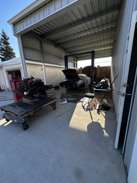

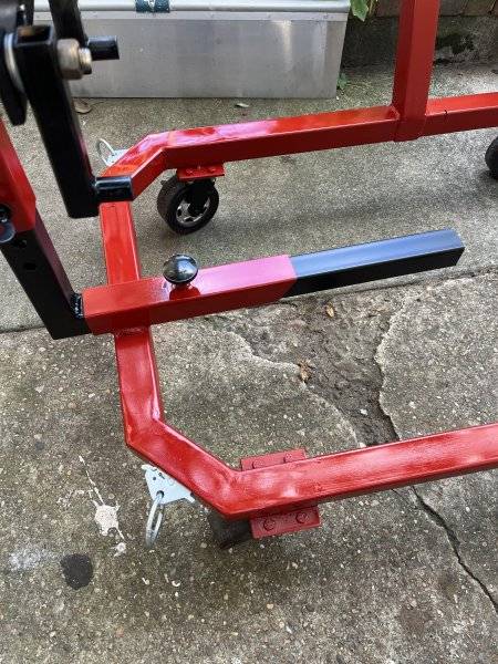

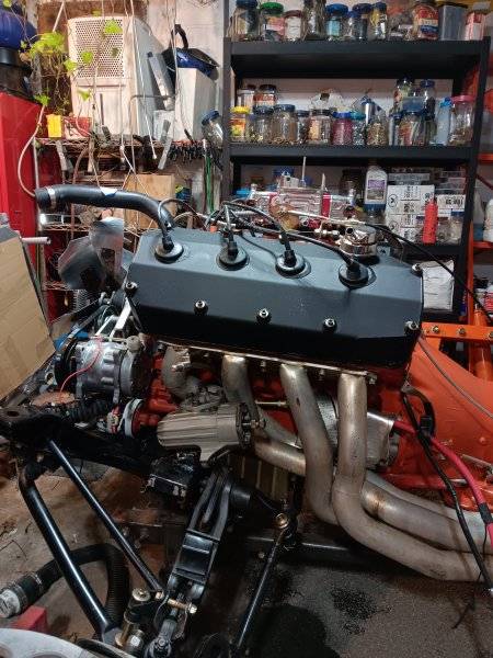

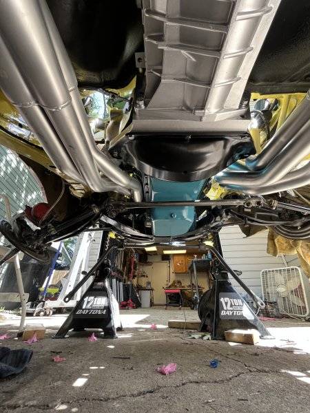

I was waiting to get my 400 block back from machine shop so I started messing around with a spare k-member and before you know it I had this ready for my 470 stroker build

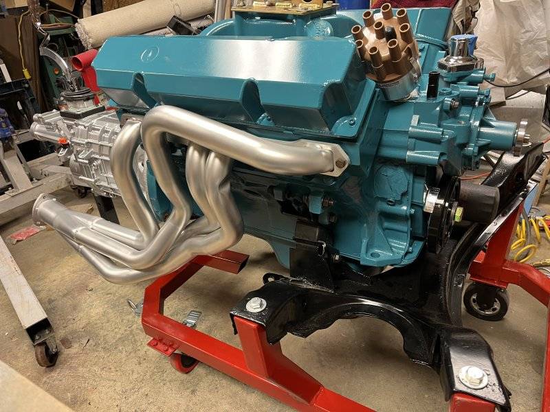

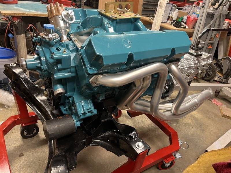

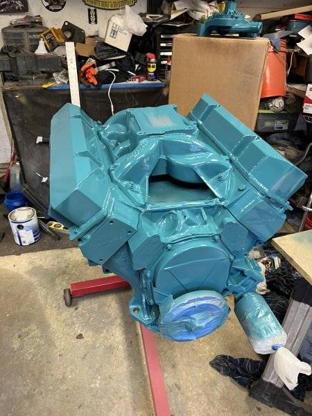

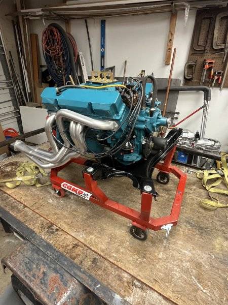

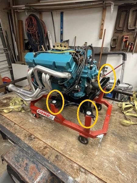

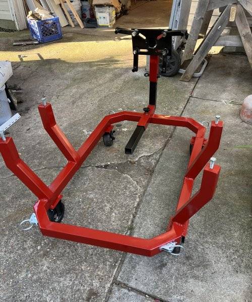

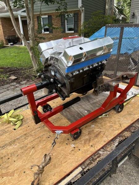

made a great transport stand. Returned engine to engine stand to paint, then back to cart for final assembly

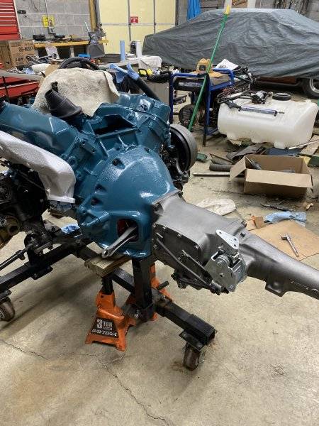

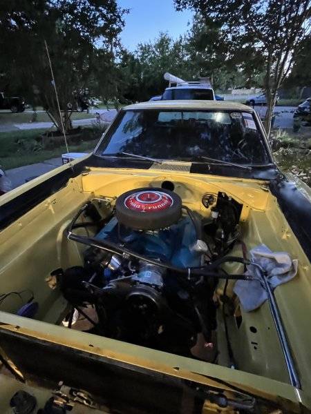

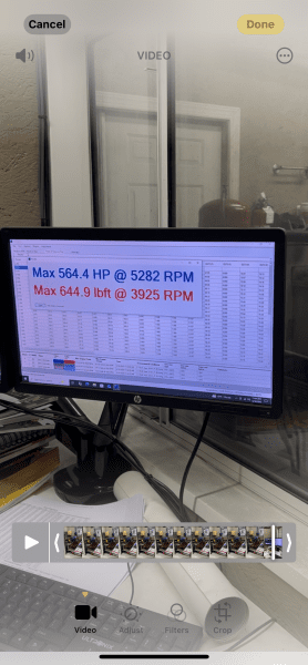

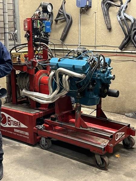

Before I bolted on Tremec 5-speed ran engine down to dyno for initial start and tune
