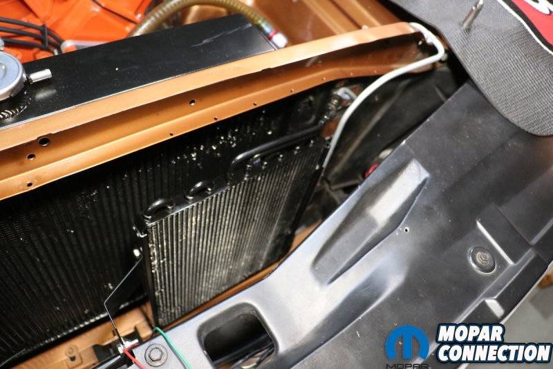

I like to mount the trans cooler in front of the radiator but to the side away from the top radiator hose inlet. The inlet side is generally the hottest point so I like to give it the clearest air path. That way, if the trans cooler disrupts the air flow, it will be in front of the 'cooler' side.

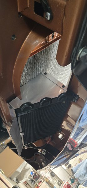

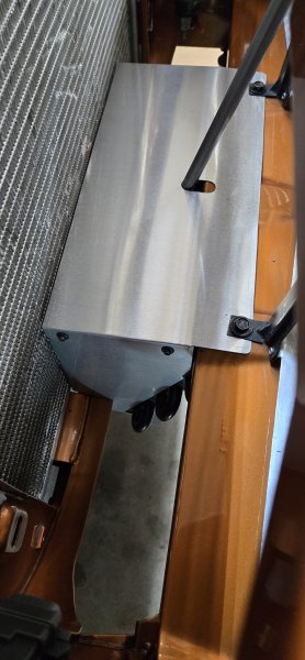

I built this duct for my racecar. No loss of airflow.
Doug
I like your fabrication work. Think that I have a plan in place, but keeping all suggestions in mind.
