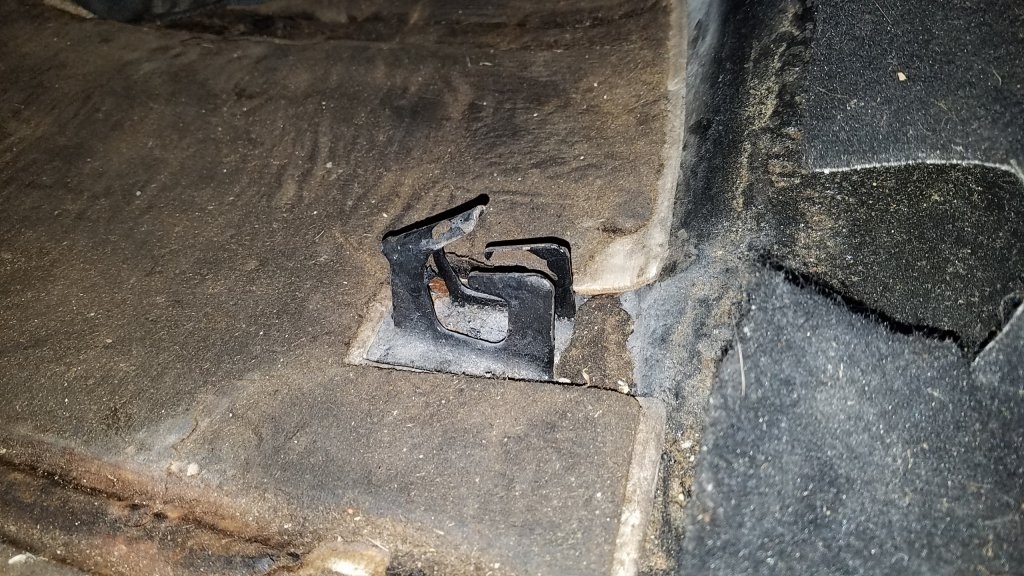

It can be a trick and can be tight. Start with the bottom. You have to push a little bit down and towards the back of the car. It should slide back just a bit to clear the hooks (don't have a pic but sure someone on here does). Once the bottom is out the back slides up and out.
I have a 73 SE car too but have modified it and removed the vinyl roof and louvers.
You may have to use your knees to push towards the back of the car and hands to push down and brace yourself against the front seats.
If no one posts a pic today I can try to take one for you tonight of the hooks.

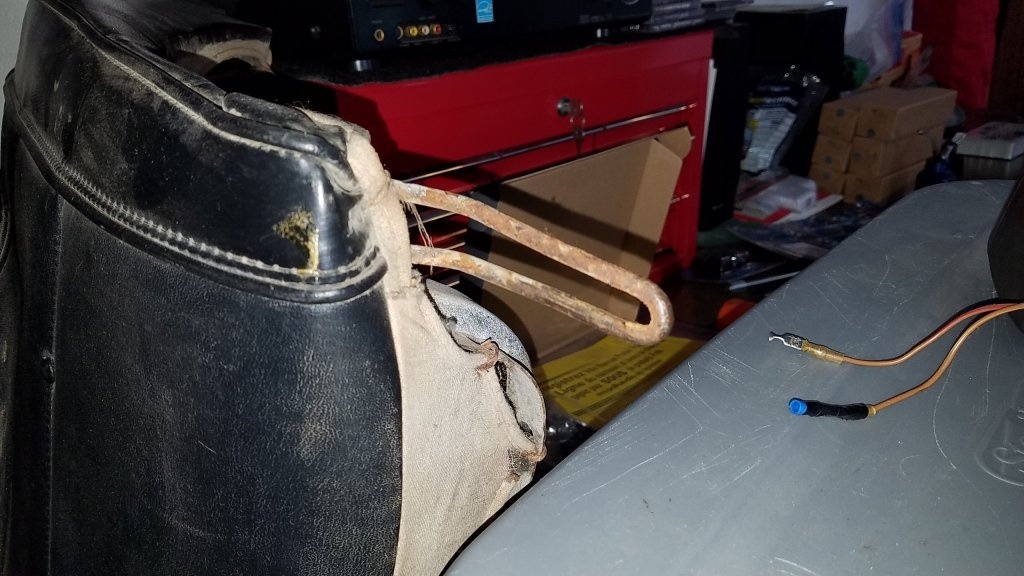

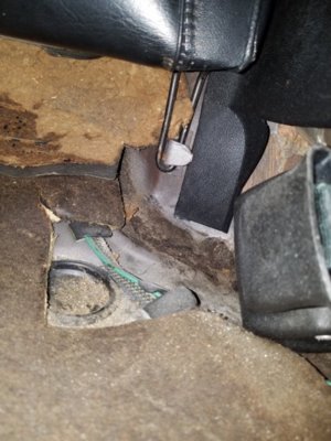

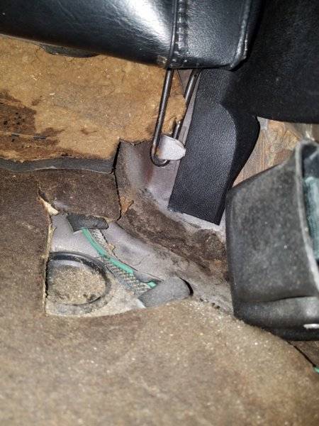

Doug - here is a picture of one of the hooks I took. There are two for the bottom seat. Front of the car is to the right of the picture.

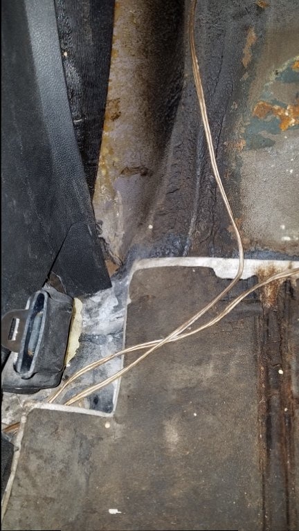

Here is the back of the seat and the lower outside corner of the car where is catches.
Hard to see but just up and to the right of the seat belt is the catch for the seat back.

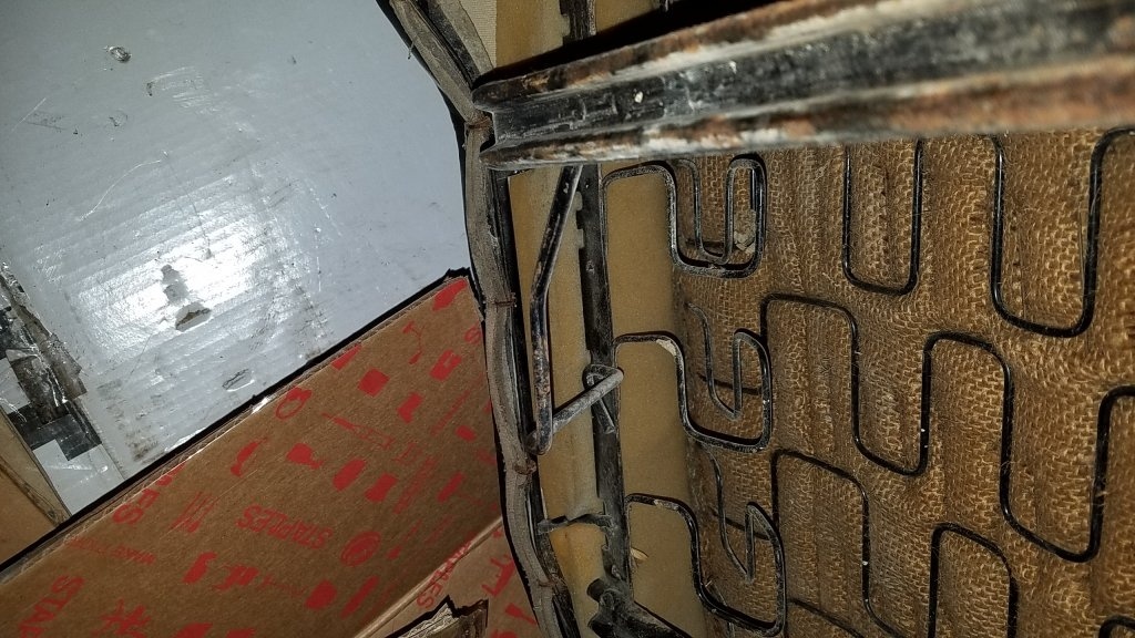

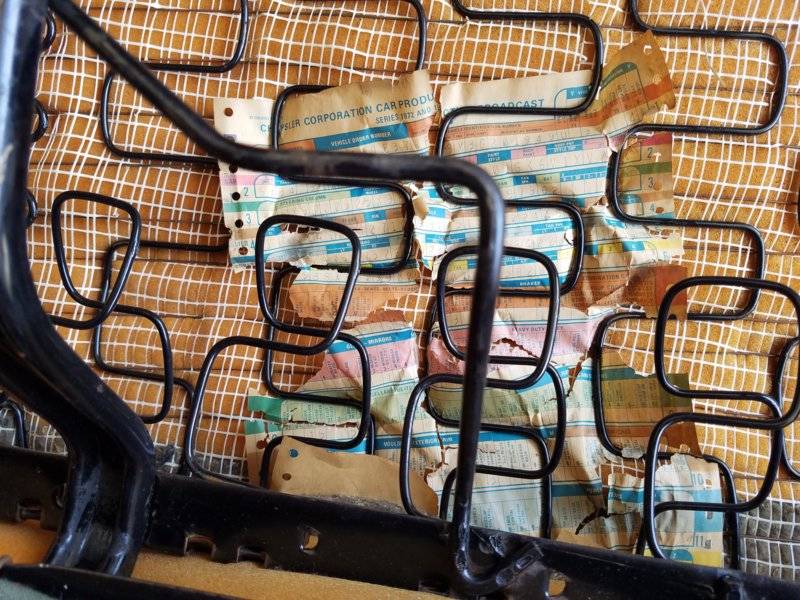

So I finally got around to taking the seat out but I see the tabs on the bottom am I supposed to bend the tab to get the seat out ?

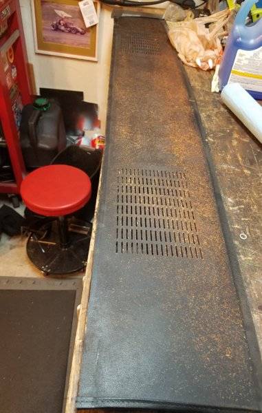

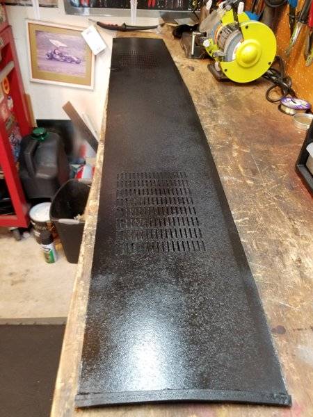

I got it out I just used pliers. I want to paint the speaker cover board its in bad shape. I found both build sheets the one under the seat was in bad shape the one on the back was really good.

I will do that thank you. Painted it one more thing accomplished lol.
