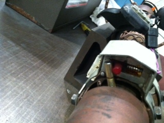

67 Coronet automatic. Should the back up lights have power with just the key on and the selector in reverse?
To answer my own question, yes. What I'm missing is the pin that actuates the column selector switch. I don't know how long it's been missing. 2880948 is the part number. Does anybody have their column out and can post a picture of what this pin looks like. I don't know if I'll find one anywhere. I can probably make one if I knew what it looked like.
Upon further inspection I found out the part missing is made from unobtainium. I did find some info about how to fix it. I think I can replace it with a bolt. I'll have to pull the column to get to it.
Over 30 views and not one comment. Unusual. I'm sure somebody else has come across this. Found the info on dodgecharger.com
your reverse/neutral safety switch should be mounted not on the column , but on the transmission. should have 3 pins. the middle pin is for neutral safety and goes to the starter relay....the end 2 pins are for the backup lights...one gets power with "key on"....and the other goes to the actual back up lights ( either pin,,,,it dont matter ) and grounds to the body just by mounting it!
Nope not the neutral safety switch. The back up light switch mounted at the bottom of the column. 1967. I got it figured out i think.

just read this, and yes it is a plastic stud that slips on the selector shaft. Break easy for sure. I have one in stash, but it can be faked like I suspect you have figured.

Yep faked it with a bolt 1/4-28. Tapped the hole as best I could and cut a bolt head offhand threaded it in. Need a new coupling seal before I put the column back in. Then when I do that just a final adjustment on the switch and I should be good to go. Then everything elecctrical will work.
