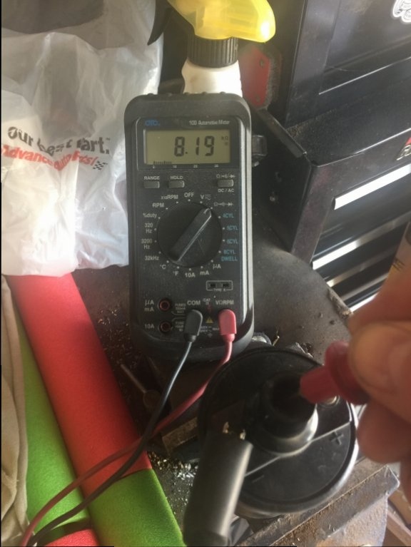

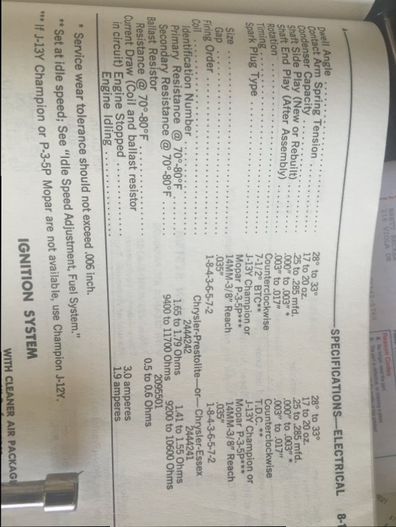

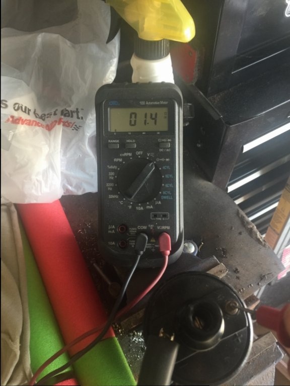

Good afternoon. Today on lunch break garage I'm trying to determine whether my coil is bad and causing my spark plugs to not fire correctly.
If your ignition coil is within proper resistance more testing is needed...

I have tested many coils over the years for the primary and secondary ohms. Many times they read normal and yet the coil was still bad and put out a weak spark. Ron
X2 Ron. My experience too.
