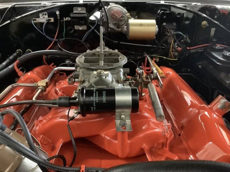

Thank you!! Beautiful engine btw!
UPDATE: I installed a factory, round ignition coil, took it out around town for about 25 miles and it's running great. Only thing is my factory temp gauge is no longer working now, maybe I bumped a wire off, have to check over the weekend.

Water temperature sensor located top of water pump housing, single female bullet connector.
Most likely U bumped it off changing the coil..

Absolutely correct!! Connected it, temp gauge back to working!
