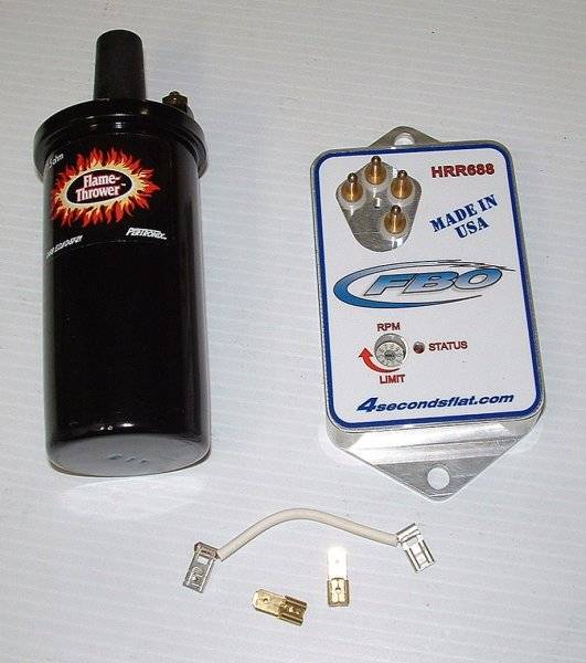

I had one of these FBO units:
It made my tachometer bounce a lot. I tried soldering in a diode in the tachometer wire but it didn't help. I have an aftermarket instrument panel that somehow isn't compatible with the FBO ignition module.
I'm only interested in a factory type ECM. Do I need to look for an old original unit?
These parts store generics and Wells brand units do work but I read that they are not rated above 5000 rpms.

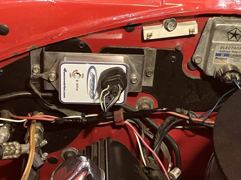

In March I installed a distributor and ECM from Rick Ehrenberg. It included this Hi Rev 7500 unit:
The setup ran great until yesterday when the ECM crapped out.

I have the FBO setup in my 68 Coronet RT and it works perfect, you have to make sure the box is grounded. I made sure it had a good ground against the fire wall, then I also ran a ground wire from the box to the engine block. No issues at all.
I ground every ignition box that I've tried in the car.
I really wanted it to work. The rev limiter was something that I have wanted since I swapped in a manual transmission. The FBO system caused my tachometer needle to bounce around. The "fix" was to use an inline diode in the tach wire. It didn't work, the tach still flopped around. I have aftermarket Dakota Digital gauges that can be troublesome with some ignition systems. I pulled the FBO unit and set it aside.

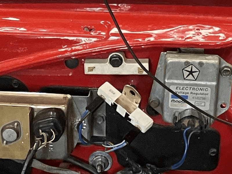

What if you ground the bracket the ecu sits on too?
Idk, Greg Im just learning as we go along here. lol
This is just a guess but I'd think that if the FBO unit is grounded, it could be just be hanging off the engine and still work. Grounding the mounting bracket shouldn't matter.
True, but it would take a man of your talent 15 min to fab one up. You have mentioned (IIRC) that you keep burning up boxes and all the pics I have seen the ecu is mounted on the this same bracket.

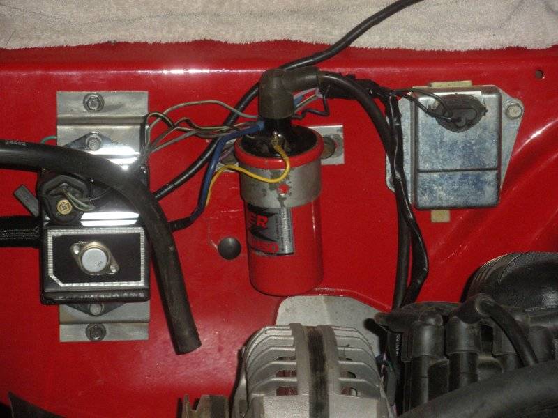

In 2013, a guy from our car club offered to help me rearrange the wiring on the car. For about a week, I had everything on the RH fender apron.

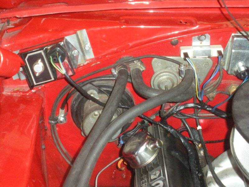

Before the A/C installation in 2019, I had the ECM in a different spot. WITH bracket:
WITHOUT bracket:
