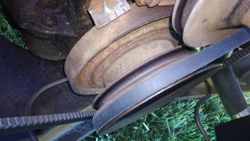

1964 Poly 318 should be a steel crank = internally balanced. Do you have a picture of the harmonic balancer? Thinner one is for internal, thicker one for external.
I don't have a shot of the balancer currently. It is rather small and thin walled. Stock motor and trans.

The balancer is fine. I checked the timing marks at TDC and everything lines up. I can't imagine the balancer rubber being bad and leaving the timing marks in the correct positions.
I'll pull down the inspection cover on the trans again and check to make sure all the weights are present in the torque converter next.
Cast crank motors need the weight on the converter. Steel crank motors do not use a weight on the converter. In your pic of the dampner, it looks like a Steel Crank..
