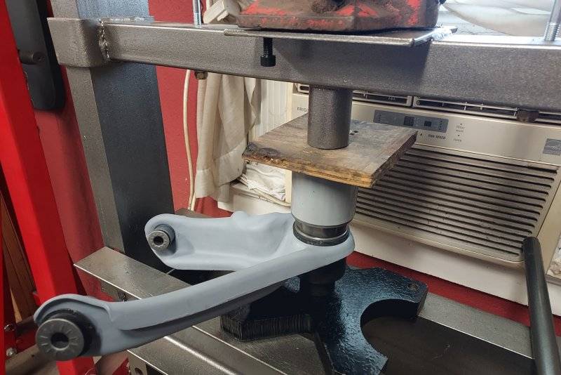

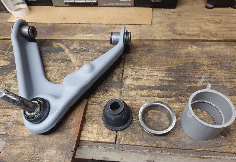

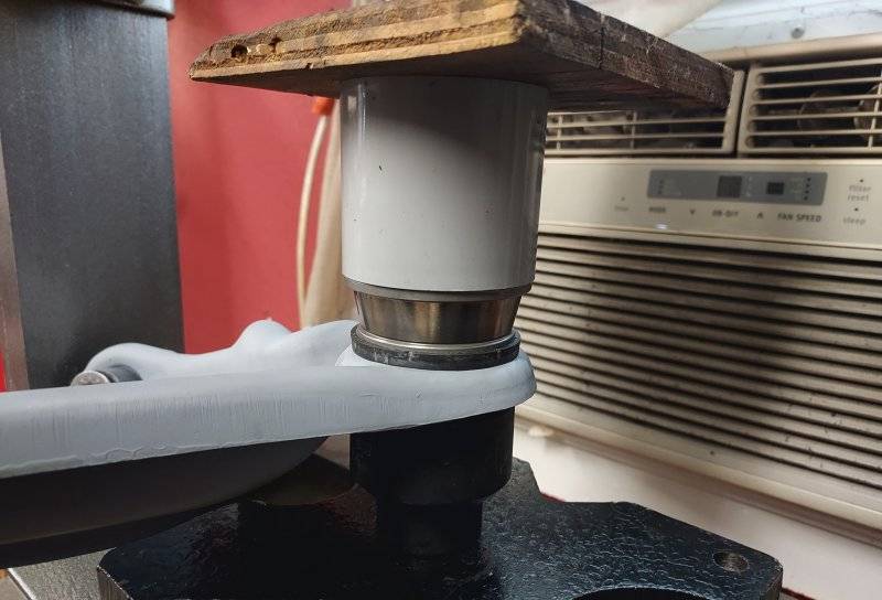

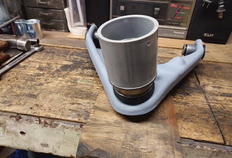

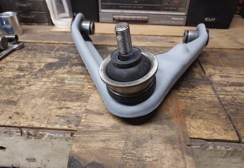

You have to find something that fits snug without any play. I'm using a bearing race then a conduit coupler.
View attachment 1702272View attachment 1702273View attachment 1702274
Then gently press it on. Hitting it with a hammer would just bounce off.
Exactly how I do it... Though my old bearing race looks like it's been through a war... Yours looks just spiffy...
