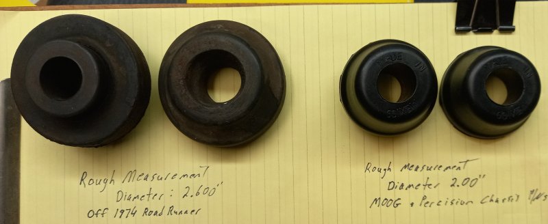

I am searching for a set of correctly sized strut rod bushings for my son's 74 Road Runner.
As you can see, the originals are 2.600" squeezed, so I will go with a minimum of 2.500" OD for my needs.
The Moog/Clevite and Precision bushings (same part numbers) K7016A called for are only 2.00"OD.

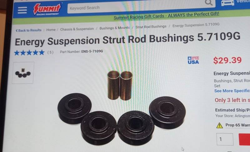

I did find these on Summit, but there are no dimensions listed.
I know they are not factory style rubber, but if they fit, I will run them.

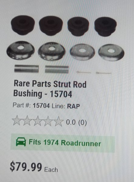

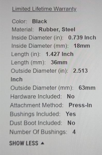

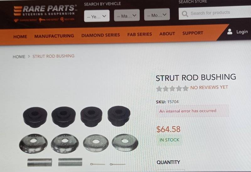

I found this Rare Parts P/N that are 2.513" OD, but they are not avalible and I have had no luck locating any in the past.
If anyone knows the OD of the Energy's that would help.
Thank you,
Bushing #1 I.D.0.739
Bushing #1 O.D.2.513
Bushing #1 Length1.427
Bushing #2 I.D.0.739
Bushing #2 O.D.2.252
Bushing #2 Length1.367
Hardware IncludedYes
Package Contents4 Bushings, 4 Washers, 2 Sleeves, 2 Cotter Pins
