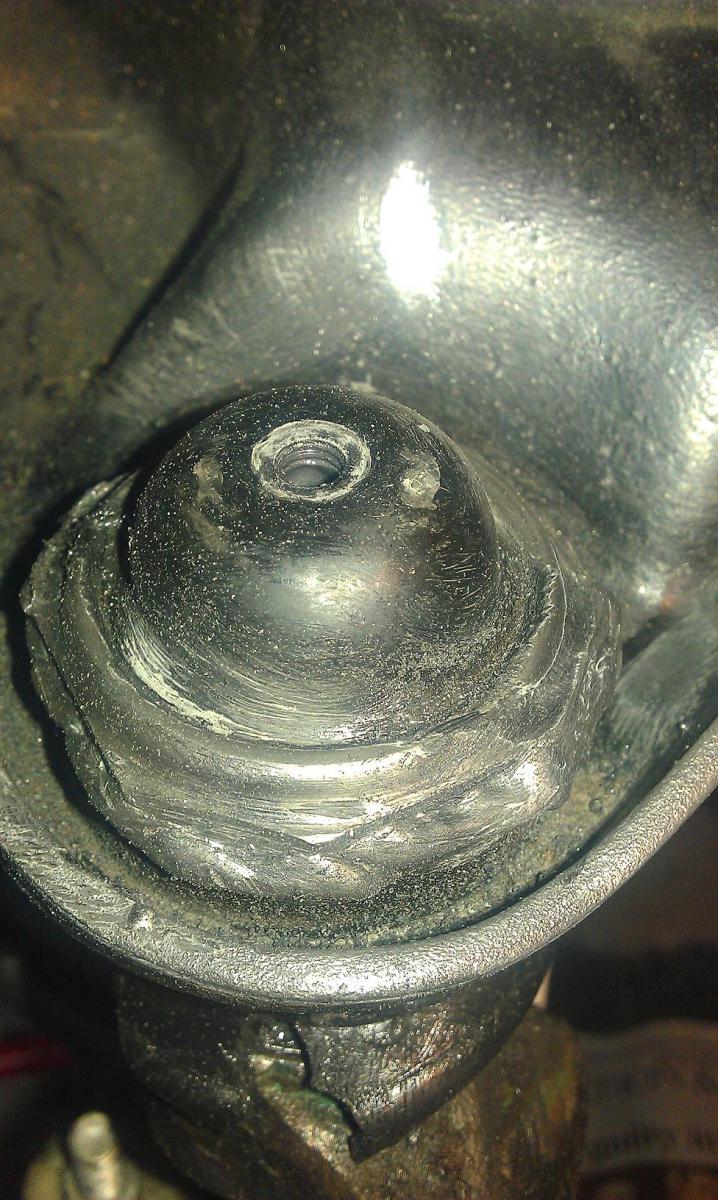

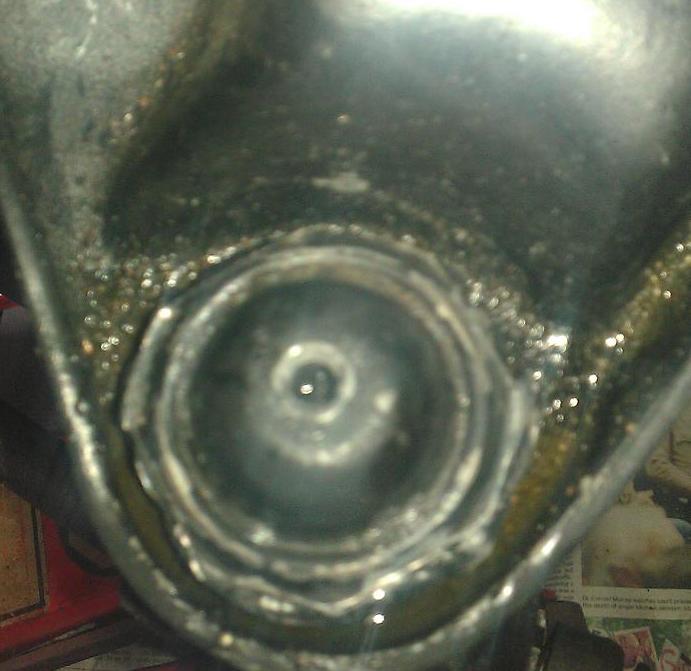

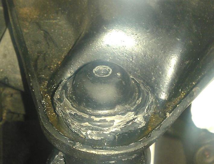

I am rebuilding the complete front end and the upper ball joint head at least on drivers side (Haven't gotten to the passenger side yet) appears to have been stripped out whenever it had ben installed. I have the 1 59/64" ball joint socket and tried to lightly tap it on the ball joint but the socket seems to small to fit. The ball joint top however isn't in good shape to begin with. Any ideas on removal would be appreciated.

Hard to see with all that chipped paint but it looks like it's welded on! (I have seen it before!) Wire wheel it off real good and get a better look at it.
Yepper welded for sure! I would buy those arms with the ball joints installed! Heck I think I will buy a set for my 69 Charger!! Can't beat that deal!
Not surprised seeing them welded.
Very typical when the threads are ruined.
I agree go with the aftermarket uper arms with the ball joints already in them.
Finding good original arms that are not wrecked are getting tougher to find.
Hell, oe style arm are reproduced, so that is another option.
