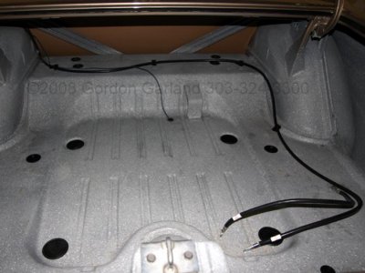

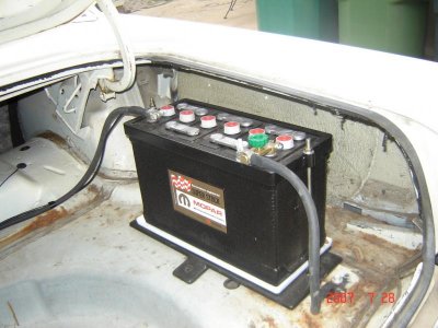

Anybody have pics of their setup? I need cables for my 64 anyway, and I don't think it would look right with the batt in the bay. The turbo start batteries are listed as a "sealed" battery, but are they the same as an optima style battery? I'd rather not have to vent it if at all possible. I would recommend a good quality isolating clamp to secure the exposed cable. Where do you guys secure your ground cable?

These pictures are from the 65 Plymouth Texas Rattler.
Thanks to all who replied and the replies were very helpful.The pictures were great

If you notice. I ran mine threw the trunk floor and alone the frame rail. Then across the tunnel and down the drivers side. Attached with rubber mounting brackets. My cable may look a little loose right now cause its not finished. Safest way to run in my experience. I bought my battery box from Summit. Comes with all hardware needed. Red with a lid and strap to secure battery in box.
