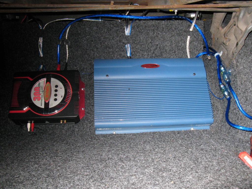

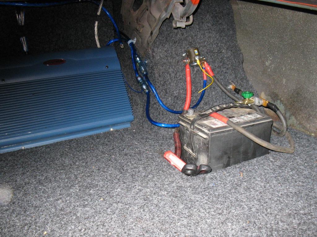

I have a few finishing touches to do on mine, but here is what I did with some advice from members here.
I used 1/0 welding cable from the starter to the soleniod in the truck and ran it through the frame rails, and the same size cable from the battery to the solenoid. Also used the welding cable for the ground in the trunk as well as the ground for the motor to the frame. Then I used 4 ga wire from the alt to the battery in the trunk. I used a Ford noid so that the cable to the starter only has power on start up. The trunk relocate makes it much better for hooking up the stereo LOL.

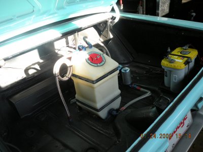

Cheap and easy - albeit not the best looking container around. Box seals the battery and one line through the floor to vent.

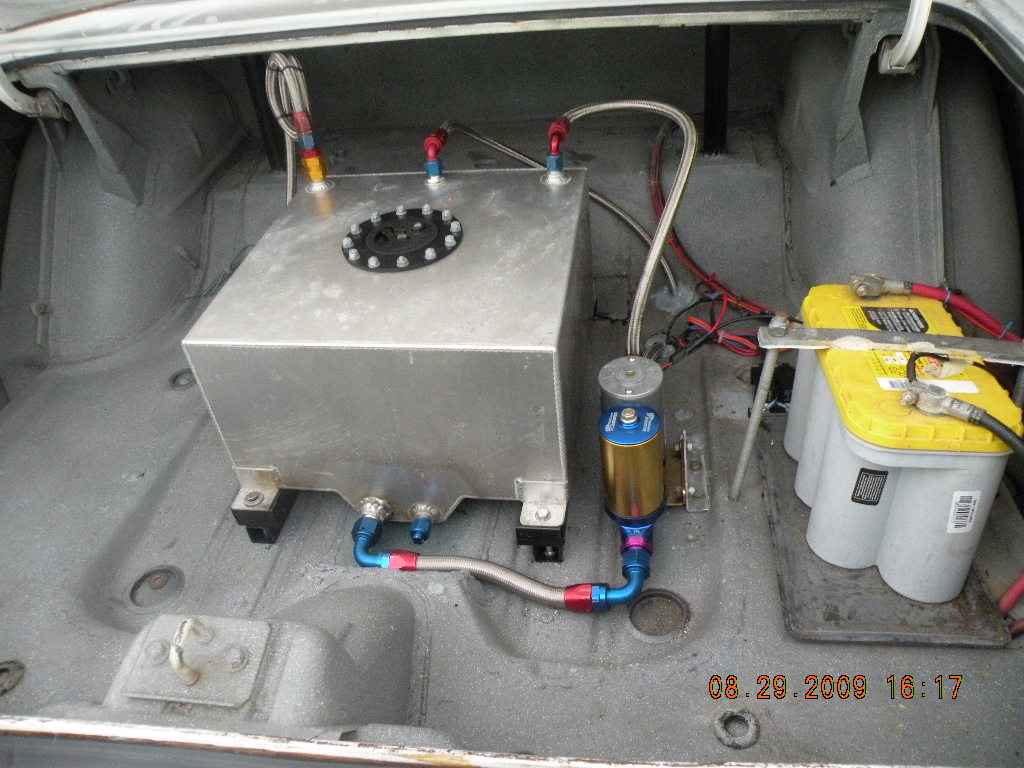

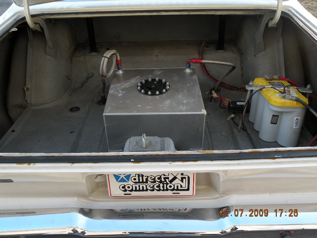

I am not sure if it would have to be vented, the factory lightweght cars were in the trunk and no venting there.. Also seen several 62 Darts relocated and no box, vent or anything, just a battery in the trunk. I am doing mine over the right wheel for racing purposes; to put more weight over the axle.
battery needs to be in a sealed box if your trunk area isnt sealed off with aluminum behind the back seat. if your sealed off, then no box is required.
