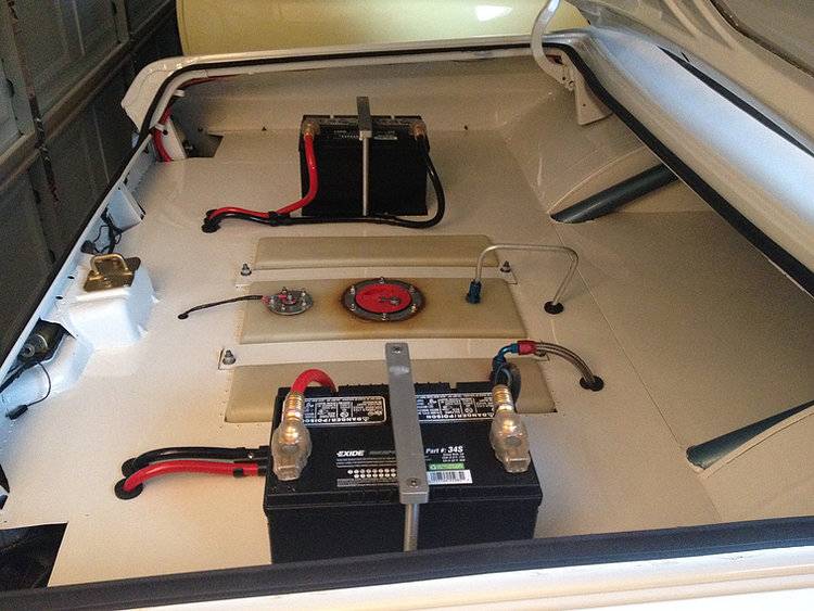

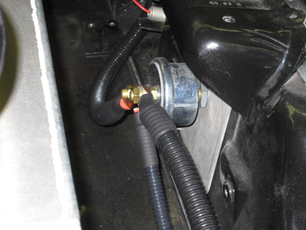

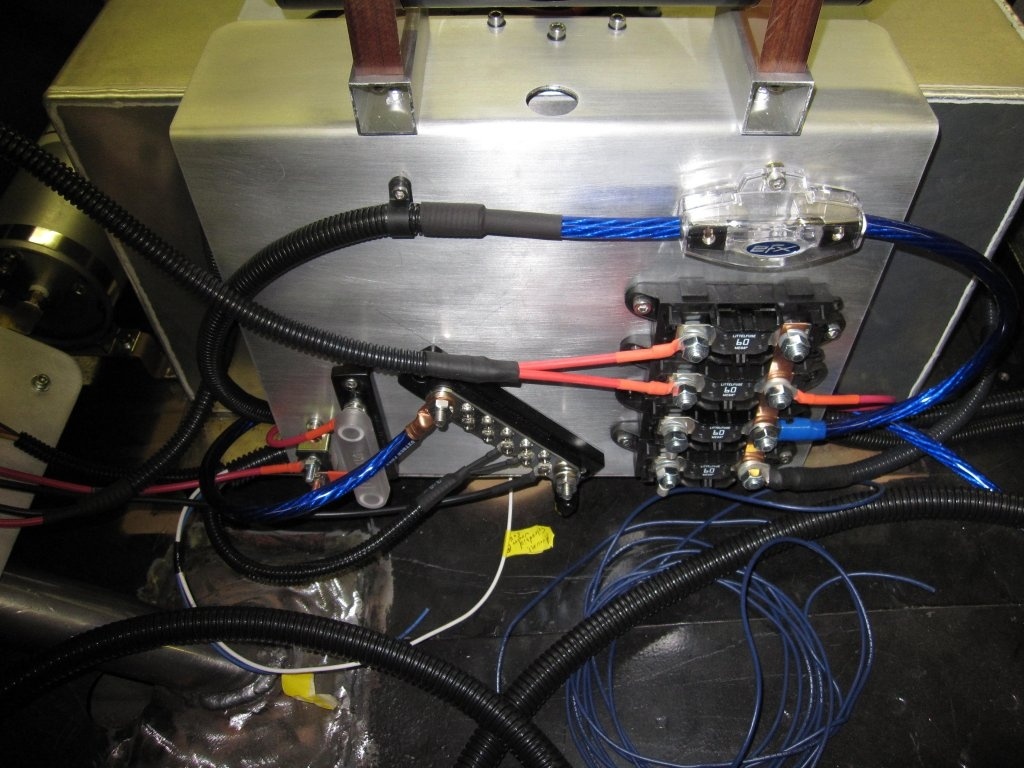

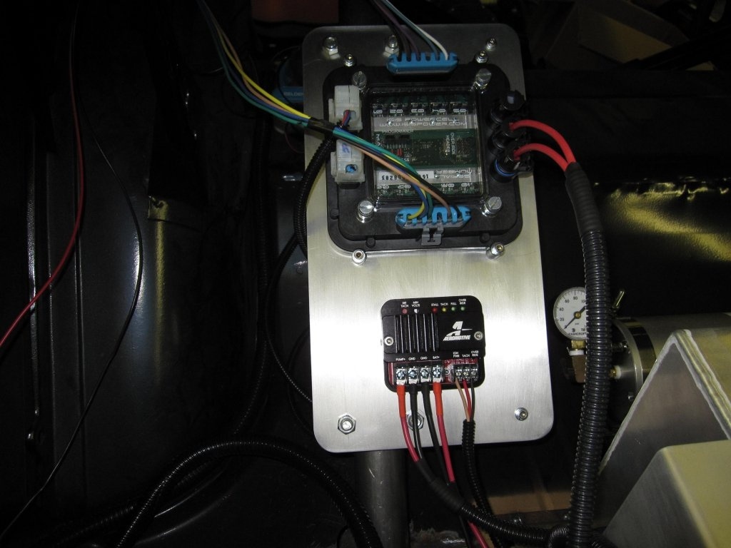

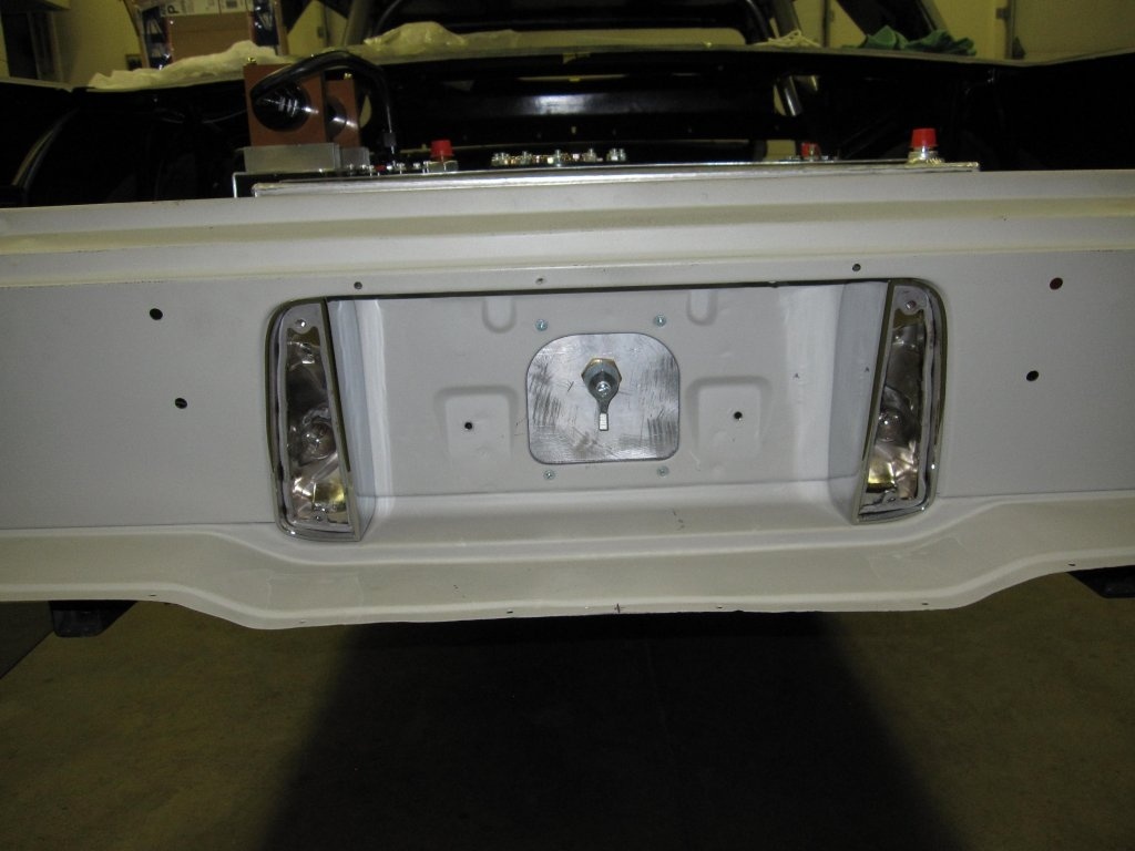

View attachment 361863 View attachment 361864 View attachment 361865 View attachment 361866 This is my partially wired trunk. The 1/0 positive cable runs up the left side under the wiring chase cover over the rocker panel and is inside a length of wire loom for extra protection. I am using the body for a ground also. It has worked in 2 of my other cars. My battery switch as you can see is behind the license plate. The large terminal module is a Powercell for the Infinity Box wiring system. The small box below that is the freq drive for the A-1000 in the fuel cell.

That looks great, nice work!
Beautiful!!!!!!! Love how clean that trunk is

Tempest 455 that is beautiful work in your trunk. I dont know if I could even afford some of them awesome parts you used but I commend you on such awesome work. You should be very proud to show off that trunk ! Ron
Thanks but I can't take credit. The chassis builder did that work. I posted it at reference as I think it was a nice job packaging everything higher with the suspension below.

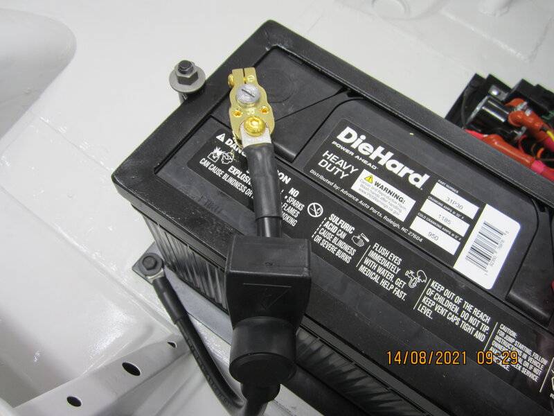

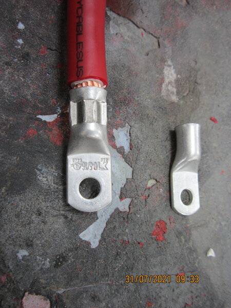

I used those same battery terminals and their matching boots. I think I got them from Amazon or Summit. I made all my cables using a Harbor freight hydraulic crimper. I bought # 64044 as its has America cable wire size crimper dies. Most crimpers out their are metric. I used 1/0 cable. I used heat shrink that has a glue coating inside. When you heat shrink it the glue melts and makes a sealed crimp. The 1/0 cable has 2 layers of protective shield, a white inner one and a red or black outer one. I got the Red and Black cables, terminals, and heat shrink from "gaugewireandcable" on e-bay.

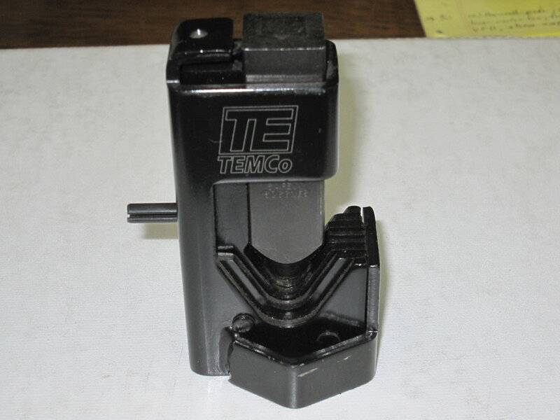

I purchased this hammer operated crimper online somewhere. It works well.

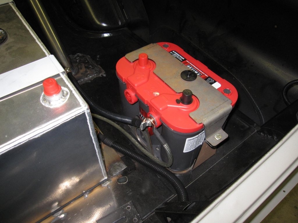

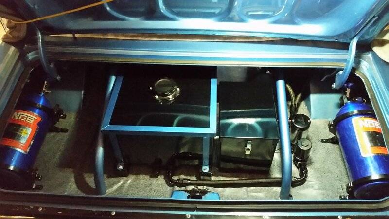

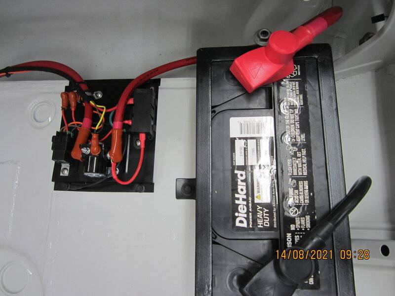

Mine is mounted in the trunk and crimped and sdered the connectors (on the entire car). Also have external on/off switch hiding at the right rear between valance and bumper..
