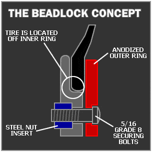

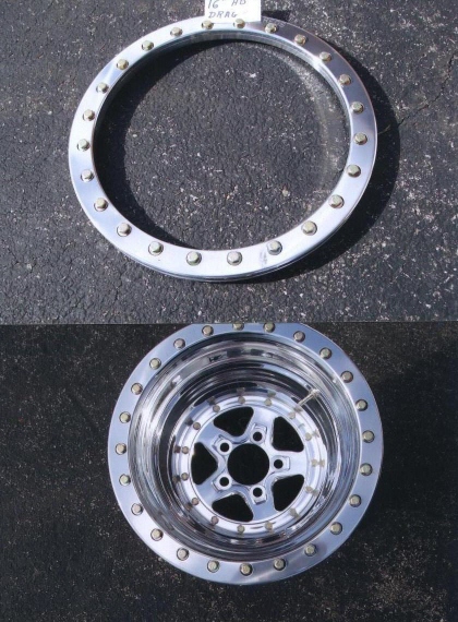

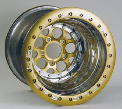

most guys these days in the 4 x 4 / crawling / drag racing world use actual beadlocks .

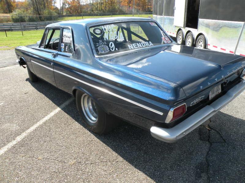

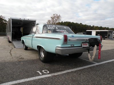

something is qwrong, i have run tubeless screwless m/t slicks going low 9's with no issues at all. only thing was losing air after a weekend of racing and it sucked to air up every few days so i just added tubes and screws because running slicks with tubes and no screws is a formula for disaster.
