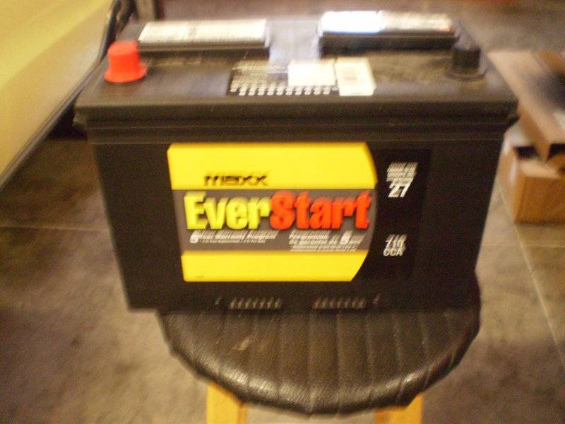

For the battery: a Walmart Group 27, with a Weskcar cap and decal set. Go to their website for pictures and ordering info.

Your battery is probably a group 24 or 27. Any auto store can help you out.

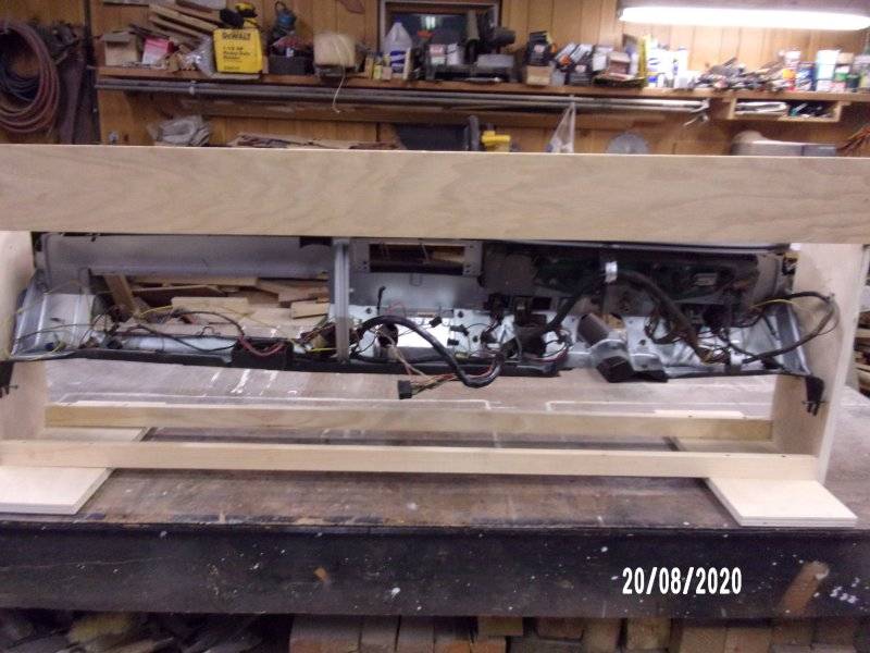

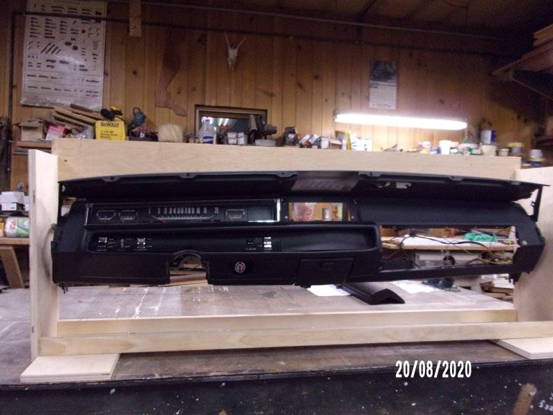

For assembly of the dash make yourself a jig to hold it and you can also test to make sure lights and gages are working. Two AA batteries will give you 3 volt and the gages work on 4 volts, so you can safely test the gages with no harm. I'm sure other members may provide more info on that when you get to that point. If you have a question, just ask, lots of knowledge here on this site and all are happy to help.
