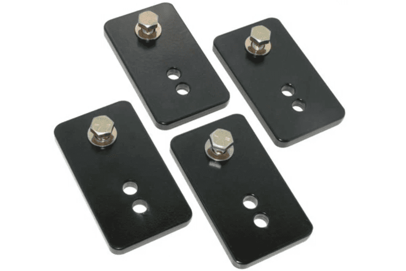

Hi members
My seat is all the way back on the tracks and still too close to the steering wheel for me.
I have an idea how to move it back but am curious if anyone has done this and how it was done.
My seat tracks were powder coated when I got the car and the studs were missing, so I used carriage bolts to install.
I'm thinking just make some pieces with studs to bolt to the tracks and holes further forward in them to bolt to the floor, if you get what I'm saying.
Thanks in advance.
If you have a better idea, I'm open to suggestions
Dave

You can buy seat track extenders from Summit or Jegs. They move your seat back 2" . Kind of what Dave was mentioning at bottom of Post#1. Way easier than losing weight. LOL.

This is what I used, relocation kit.
