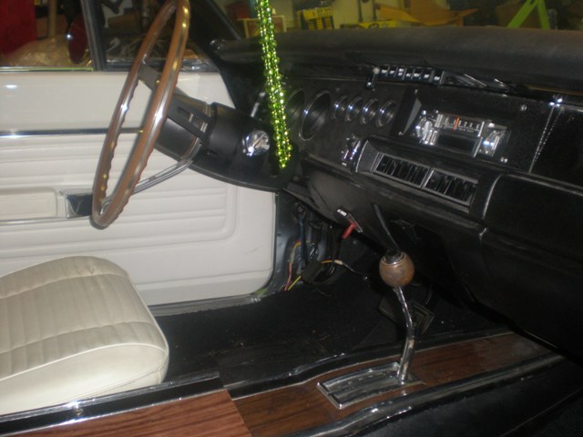

Not entirely true. I know of a Hemi Charger that has buckets, console, and COLUMN shift from the factory. The console had a blank plate where the shifter should be. Was a radio delete (read wasn't ordered with a radio) car as well.
one odd duck
Do any of you guys want to sell your bench seat? I need one for my 1970 Road Runner.
one odd duck
That is very odd, I don't doubt it, Sounds like another "one off goof ball" , Now I bet you Chrysler wound swear they never built one this way.

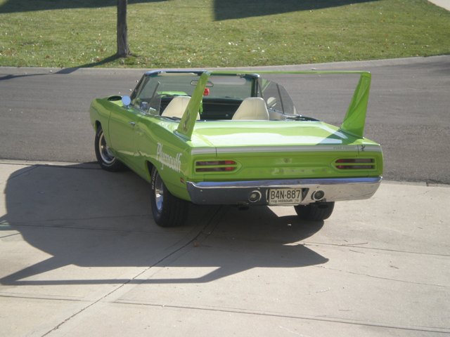

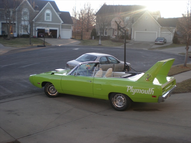

Thank God the Superbird has buckets because everyone wants to ride in that one.
