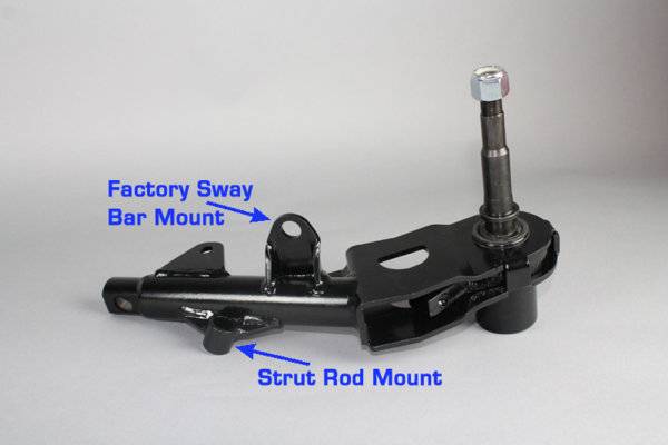

along with the QA1 LCA's & a QA1 dynamic adj. strut rod
all just like the photos I posted above...
What is the advantage of these?
Is it the weight savings over a stock 1962-72 LCA ?
They are good, look great and now the newer one come with the bump stop location on them. They work perfectly with all the stock or aftermarket UCA’s, strut rods and spindles.
The guy that said they don’t work with aftermarket stuff should be fired or at a minimum some extra training on the product.
