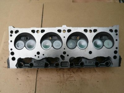

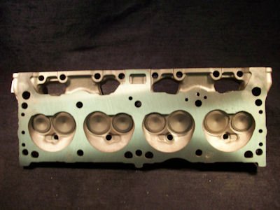

The 920 is archaic compared to the 302 head. The 302 is a modern, swirl port, high velocity, small chamber head. The 920 is a stock head with small chambers. NO swirl or high velocity characteristics. Here's the difference in chambers.
920 first and then the 302. Although they appear similar, they are NOT the same by a country mile.
