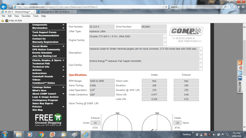

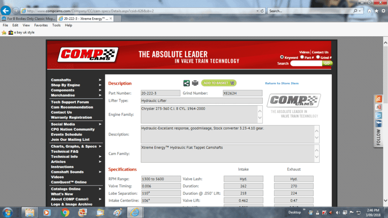

what about this one
It is very similar intake duration wise to your other (3rd) choice @ 224 which I shyed away from because of the gear and tire size combonation. Like I said in my second choice, it may take some foot to clutch pedal finesse to get going. The cams rpm range starts a little higher up than what would make for a good driving combination.
Once you start moving the car, somewhere around 1900-2000 everything starts catching on and working well. While I listed the rpm ranges a bit above what Comp has listed, it may have a slight curve beyond what they stated, it is the overall package that has to be looked at.
The cars gear ratio & tire size I have stated but also the cars weight and size. Being a B body, a very similar set up to my ‘73 E body 340/4spd that I have had for the last 32 years under multiple changes of stock to race parts from stem to stern. Finding the sweet drivers combo with the 3.23 gears it was born with always lead to a smaller cam.
The smallest cam I had was a Crane 216/228-.454-.480-112 in it. I had at the time the same gear ratio and tire size as you have now. I had to use mine as a daily driver for work in and out of NY city. (A 30 mile car clogged rush hour one way trip)
After a tire diameter reduction, (235/60/15 - 26 inches) the drive abilty was enhanced with an easier roll off the line and not so much clutch work to get going.
If your looking for a more performance oriented ride 1 step above stock, go for it. I tried to keep the cams listed in a operating range with consideration of the current combo of the car and the car itself in mind. The centerlines are at 110, in which that should provide the typical muscle car choppy idle.
In my 4spd Cuda I have run the 275/60/15’s with a cam duration @ [email protected] and a 4.10 gear. I would side step the clutch at 3500 rpm’s as that was about the best area to have the car get up and GO! Around town, it was crappy.

XE262H still do not know compression but best so far if stock Intake and exhaust closes 57ABDC
IMHO 274dual energy is a gimmick and is worse than 270H intake closes 64ABDC
will loose a lot of dynamic compression
256-262 Lunati looks better than 270 or 274 comp's intake close would be about 54 ABDC
262/268 lunati much better choice than XE268 comp

I'm going with your first choice it seems to be what I'm after, a bit hotter than stock but not over the top
so at the last minute, I went with the above XE268H #21 instead K20-223-3
but included this as an upgrade
They are both old 1977 vintage chevy profiles
pick one with the 262 duration and the 268 lift
